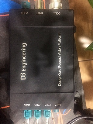

    Currently, we use OV10640 +TI 913, and  let me make it clear.
    We have two version hardware D3 RVP.
    D3 RVP1
    D3 RVP2
    For D3 RVP2:
    We can run user case by using image file supplied by D3 Engineering RVP, which is stored in SD card, when we received the board.
    But if we compiled image file from VSDK_3, this can not work.
    For D3 RVP1:
    We built image file from VSDK_3, it can work very well.
    Maybe D3 RVP1 and RVP2 have hardware difference?  Should I do some modification about board setting?

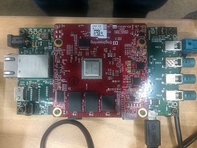

    I checked source code of D3 RVP Engineering V2.12(supplied by D3 when we bought the board), they did some different board setting, I am dig in now.
    If you have any clue about these two version RVP board, please let me know, thank you!
  • Hi Sujith:
    I think I may solved this problem, I added code for RVP starter kit, something about board setting.
    The hardware is different.
    Thank you again, Sujith!

  • Hi Mark Gred,
    Please unzip the file " STARTKIT_02_12_00_00.tar.gz" located in SD card\source\.
    And compare with file "bsp_boardTda3xx.c" between VSDK(TI release) and STARTKIT_02_12_00_00(D3 RVP release), then, you will find RVP board setting is different. Mainly in function call "Bsp_boardTda3xxRvpInit".
    Hope this can help you!
    Good luck!
