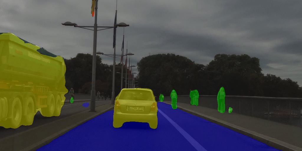

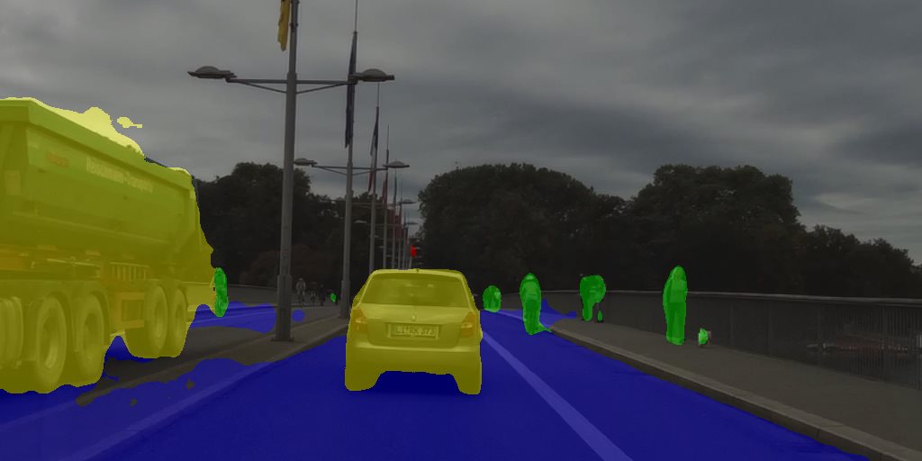

I have further tested the said scenario with TIDL and pre-trained jsegnet21v2 initial model (downloaded from: https://github.com/tidsp/caffe-jacinto-models/tree/caffe-0.16/trained/image_segmentation/cityscapes5_jsegnet21v2/initial).
Below are the examples of outputs. Although Caffe with quantization produces coarser segmentation result than Caffe without quantization (which is expected), it is still pretty different from TIDL output. Is there any advice to perform a closer estimation of TIDL accuracy using Caffe-jacinto?
Caffe result without quantization:
Caffe result with quantization (12-bit for weights, 8-bit for activations, power2 scaling set to true):
TIDL result (bitwidth: 12):
