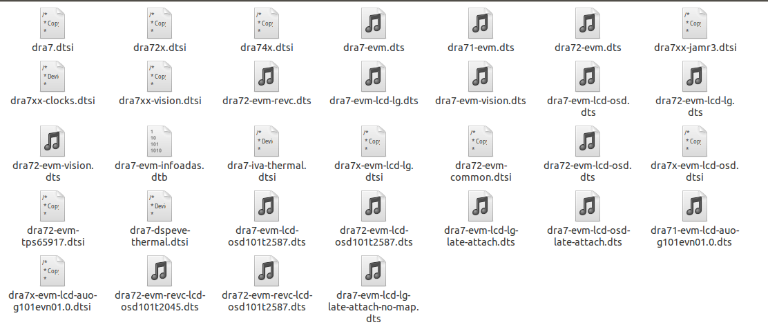

HI,
I'm using the Vision SDK(03.00.00) to build my linux kernel. But if I want to compile the dtb file with my idea, which ".dts" file should I modify? Thanks.

Hi, the dra7-evm-infoadas.dtc exists in the Vision SDK(03.02.00).I use the the new sdk.
But I still can't understand how to modify the the pins about cpsw if I want to change the RGMII to RMII mode. Please show my question to the ethernet expert.
Hi
You can refer to other TI platforms(that carry similar IP and use RMII interface to the PHY)
Refer to the cpsw configuration settings as under arch/arm/boot/dts/am4372.dtsi
RMII mode configuration needs to be specified as in arch/arm/boot/dts/am43x-epos-evm.dts
