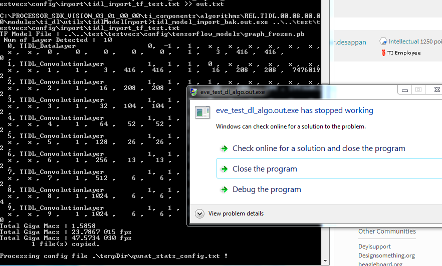

Wrote a simple CNN in tensorflow that involves 4 modules : Conv2D, Batch Norm, Relu and MaxPool which Ti deep learning (0.08) Datasheet mention's the support for these, but there are issues with the Ti conversion tool . The following is the CNN model:
Input: [1, 416, 416, 3]
Conv2D_1: [1, 416, 416, 16]
MaxPool_1: [1, 208, 208, 16]
Conv2D_2: [1, 208, 208, 32]
MaxPool_2: [1, 104, 104, 32]
Conv2D_3: [1, 104, 104, 64]
MaxPool_3: [1, 52, 52, 64]
Conv2D_4: [1, 52, 52, 128]
MaxPool_4: [1, 26, 26, 128]
Conv2D_5: [1, 26, 26, 256]
MaxPool_5: [1, 13, 13, 256]
Conv2D_6: [1, 13, 13, 512]
MaxPool_6: [1, 13, 13, 512]
Conv2D_7: [1, 13, 13, 1024]
Conv2D_8: [1, 13, 13, 1024]
Conv2D_9[1, 13, 13, 125]
I implemented the above using tensorflow slim (tf.layers and tf.nn behaved much worse) and all the conv2d layers has batch norm and Relu enabled. When i used the tool to convert the graph, the tool crashed after the first step.
The output of the first step is given below :
Num of Layer Detected : 10
0, TIDL_DataLayer 0, -1 , 1 , x , x , x , x , x , x , x , x , 0 , 0 , 0 , 0 , 0 , 1 , 3 , 416 , 416 , 0 ,
1, TIDL_ConvolutionLayer 1, 1 , 1 , 0 , x , x , x , x , x , x , x , 1 , 1 , 3 , 416 , 416 , 1 , 16 , 208 , 208 , 74760192 ,
2, TIDL_ConvolutionLayer 1, 1 , 1 , 1 , x , x , x , x , x , x , x , 2 , 1 , 16 , 208 , 208 , 1 , 32 , 104 , 104 , 199360512 ,
3, TIDL_ConvolutionLayer 1, 1 , 1 , 2 , x , x , x , x , x , x , x , 3 , 1 , 32 , 104 , 104 , 1 , 64 , 52 , 52 , 199360512 ,
4, TIDL_ConvolutionLayer 1, 1 , 1 , 3 , x , x , x , x , x , x , x , 4 , 1 , 64 , 52 , 52 , 1 , 128 , 26 , 26 , 199360512 ,
5, TIDL_ConvolutionLayer 1, 1 , 1 , 4 , x , x , x , x , x , x , x , 5 , 1 , 128 , 26 , 26 , 1 , 256 , 13 , 13 , 199360512 ,
6, TIDL_ConvolutionLayer 1, 1 , 1 , 5 , x , x , x , x , x , x , x , 6 , 1 , 256 , 13 , 13 , 1 , 512 , 6 , 6 , 199360512 ,
7, TIDL_ConvolutionLayer 1, 1 , 1 , 6 , x , x , x , x , x , x , x , 7 , 1 , 512 , 6 , 6 , 1 , 1024 , 6 , 6 , 169869312 ,
8, TIDL_ConvolutionLayer 1, 1 , 1 , 7 , x , x , x , x , x , x , x , 8 , 1 , 1024 , 6 , 6 , 1 , 1024 , 6 , 6 , 339738624 ,
9, TIDL_ConvolutionLayer 1, 1 , 1 , 8 , x , x , x , x , x , x , x , 9 , 1 , 1024 , 6 , 6 , 1 , 125 , 6 , 6 , 4608000 ,
Total Giga Macs : 1.5858
Total Giga Macs : 23.7867 @15 fps
Total Giga Macs : 47.5734 @30 fps
Apart from the crash, the above shows the batch norm/ maxpooling layers were not detected?  and the output resolution is also wrong. (after 6th layer)
Other issue when using leaky_relu gives an error saying its not supported (even though its actually PReLU). How do we address this problem?
Do you guys have  example code of all the supported Layers in tensorflow?.
I have attached the necessary files to recreate the problem.

  • Kumar, the problem reported was with relu only. There are two issues: 1/ The tidl conversion didnt happen, it crashed midway after the initial step. 2/Even the initial step the network output was not proper. The shape of the output tensor was wrong (may be the reason of the crash).
  • I could not notice any crash message in the log. Could you please help me on this.
    After 6th layer, the expecte shape is "512 , 6 , 6" which tool is printing. Max pool on [1, 13, 13, 512] would be [1, 6, 6, 512] . Correct me If I am wrong
  • Kumar, The above shows the crash after the initial step. The last max pool layer is of STRIDE=1 and padding=SAME. So it should be of 13x13. This is the tiny_yolo_v2 model configuration. I have attached all the necessary files and tensorflow code to generate this issue is my first message, in case you want to try to reproduce.
  • Crash is observed during the quantization stats collection step of import tool. can you share the import config file and imput image used in the import tool to re-reporduce the issue.
    We will check regarding the maxpool with stride 1.

  • The crash is observed because of un suported pre-process type. We have standard pre process types for CIFAR-10 and imageNet data set. The image resolution that you are providing is not suported with "preProcType =2" Please generate a RAW image ( RGB planar image) and use it for importing by mentioning it as "rawSampleInData=1" to avoid crash.
  • config1.zipKumar, tried the changes, the issue is still present. The files are attached.
  • Tool is crashing because insufficient memory for model. Crash can be avoided by setting numParamBits as 8, still we will not able to run this model as network needs high external memory to run, which is not suported in the device. Please train a model with lesser memory requirement to run on the device.
    Please the nets in the below path for refernce models (With Small memory foot print requirement)
    github.com/.../caffe-jacinto-models
    For Max Pool 2x2 with stride, We have identified a bug in the tensorflow model inmprot. It will be fixed in the next release.

  • Hi Kumar,
    We worked around the stride=1 issue for now by setting the stride = 2 in MaxPool_6. With this the tf import tool creates the TIDL models successfully and the stats tool also generates output binary during the import process.
    We also verified that the newly genreated TF model is actually larger than the older model.
    What we observe with this new model is that when we run host emulation on a test input, the output is generated as expected and there is no crash observed. This is with the default MMU configuration.
    Why does this even larger model not crash without the MMU changes that you suggested above? Is it possible that the crash had nothing to do with the model size in this case?
    Bhargav

  • Hi Bhargav,
    Could you please try with below fix in "tidl_tfImport.cpp" file,
    at line #1010, replace this if condition…
    if(TIDL_isInputConv2D( pOrgTIDLNetStructure, layerIndex, tfGraphDef.node(i).input(0).c_str()) &&
    (tfGraphDef.node(i).attr().at(std::string("ksize")).list().i(1) == 2) &&
    (tfGraphDef.node(i).attr().at(std::string("ksize")).list().i(2) == 2))
    with this below if condition..
    (tfGraphDef.node(i).attr().at(std::string("ksize")).list().i(2) == 2) &&
    (tfGraphDef.node(i).attr().at(std::string("strides")).list().i(1) == 2) &&
    (tfGraphDef.node(i).attr().at(std::string("strides")).list().i(2) == 2))
    Praveen

  • Hi Praveen,
    I was able to compile the model conversion tool with your fix. I'm still seeing an issue although this time a different one.
    When an activation map of 13x13x512 is input to the max pooling layer with stride=1, the output is 12x12x512.
    The expected output should be 13x13x512.
    Can you please look into this?
  • Hi Bhargav,
    We fixed some issue in "tidl_tfImport.cpp" file, Could you please try below fix..
    at line #1134, replace this below code…

  • With this fix, the output of max pool has the expected size i.e. 13x13x512.
    However, when I run host emulation with generated model bin files, I get floating point exception in tidl_tb.c at line #660.
    Apparently, conv2dPrms->numGroups is 0.
  • We are not getting this exception at our end . Can you please share the generated model bin files to replicate the issue.
    Btw, do you have access to source code and did you increase the allocated memory to run on host emulation ?
    We were getting an exception as the current allocated memory is not enough to run on EVE host emulation , so after increasing the memory this exception is resolved and could able to run this test case.
  • You can find the model bin files here: drive.google.com/.../view
    I do have access to the source code and I increased the tempIOBuf memory to run on host emulation. I was also getting the memory not enough exception without this fix.
    Can you try with attached models and let me know?
  • Can you try increasing "EXTMEMNONCACHEIO" buffer instead of tempIOBuf buffer?
    Change this below at line# 248 in "tidl_tb.c"
    #define EXTMEMNONCACHEIO_SIZE (4*1024*1024*MAX_ROI_SUPPORT)
    to below..
    #define EXTMEMNONCACHEIO_SIZE (8*1024*1024*MAX_ROI_SUPPORT)
    Praveen
  • I increased EXTMEMNONCACHEIO and reverted tempIOBuf. I still get the same error.
    I doubt that numGroups has anything to do with memory settings. Can you please try with the model bins I gave you and see if you get the same error?
