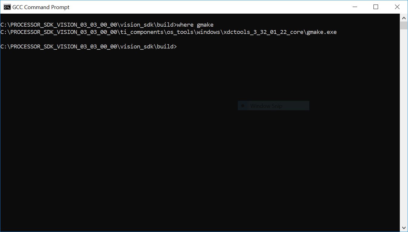

  • Hi Willson,
    Can you just run "where gmake" & confirm it is pointing to <install_dir>\ti_components\os_tools\windows\xdctools_3_32_01_22_core
    Surya

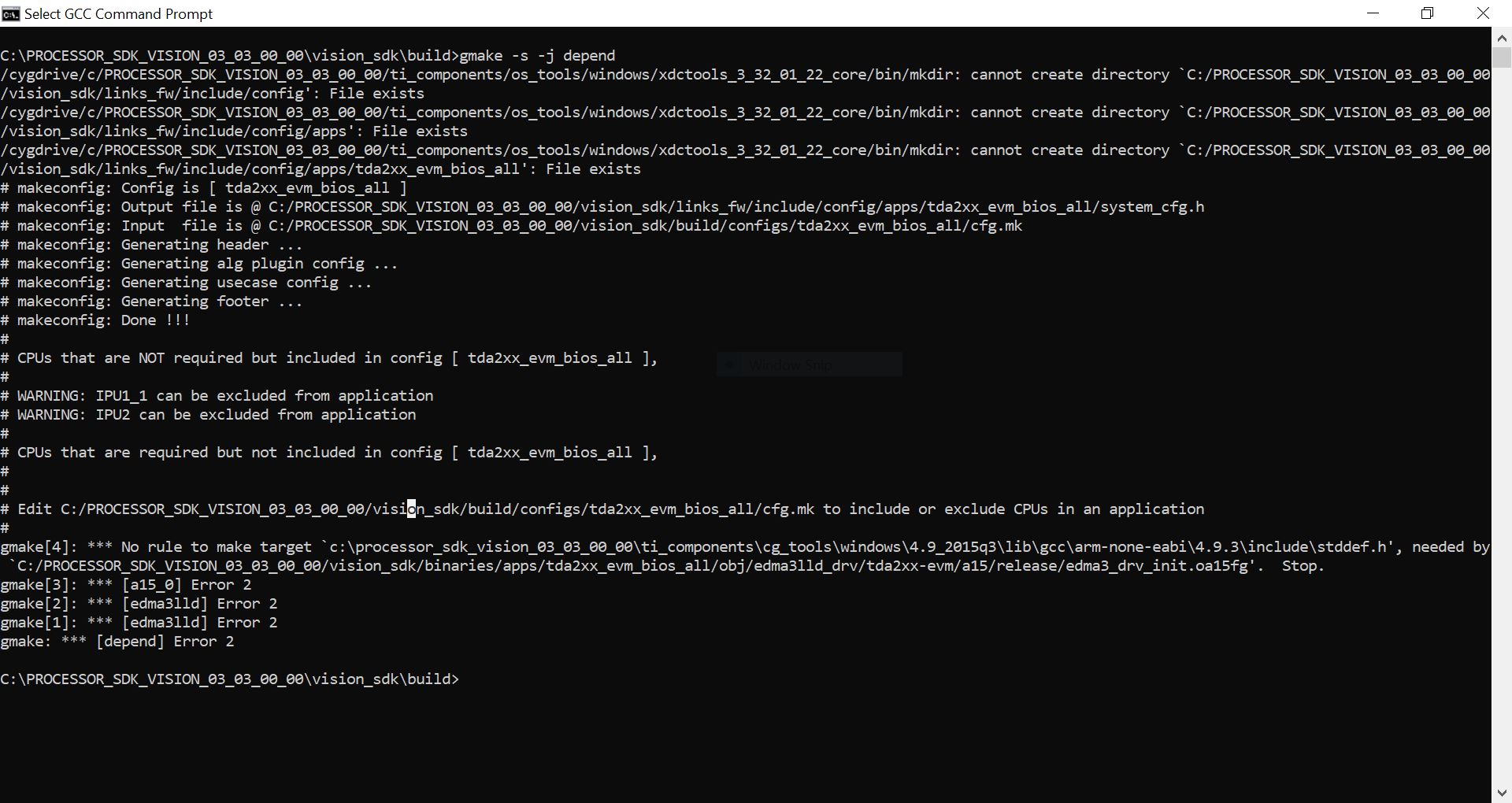

    Can you run dir command in the location $(TI_SW_ROOT)/cg_tools/windows/4.9_2015q3 ans share the result.
    Rishabh
  • Dear Rishabh
    As requested.
    The compiler seems to be there.
    From the error log you had shared initially the compiler path is set to "C:/PROCESSOR_SDK_VISION_03_03_00_00/ti_components/cg_tools/windows/gcc-arm-none-eabi-4_9-2015q3/bin/arm-none-eabi-gcc".
    You should rename the folder 4.9_2015q3 to gcc-arm-none-eabi-4_9-2015q3 and try.
    Rishabh
  • Dear Rishabh
    The error is solved but another error cant out which as show below. Note both command with "gmake -s -j depend" and with -j has the same error
