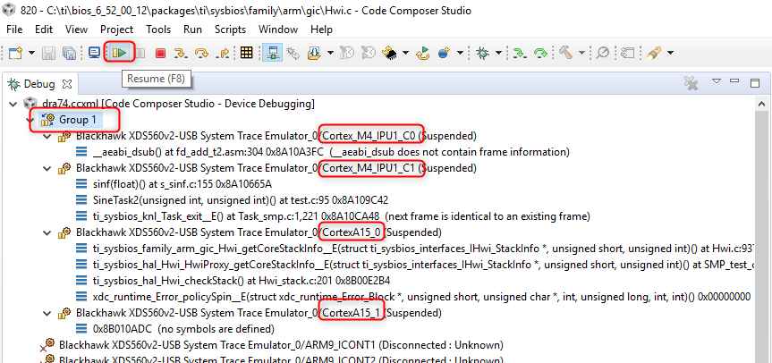

No.1 : SMP Debug issue
Not work the Cross-Trigger in case of using the AM574x IDK. Here is the reproduced way.
 1. Sync Group the Target the A15_0 and A15_1
 2. Connect the target
 3. Load the program for each core.
 4. Run the program.
 Note: When I used the AM572xIDK, it was worked well.
No.2 :  Sync Group issue
When connected A15 cores with sync group, the group was forced release the sync group. And when re-select the sync group, it showed the following error in case of using AM574xIDK.
CortexA15_0: Trouble configuring cross triggering: Error enabling this function: There is no AET resource to support this job.
CortexA15_1: Trouble configuring cross triggering: Error enabling this function: There is no AET resource to support this job.
In addition to this, when connected the A15_0 core and IPU1_C0 at first and selected the sync group, it also showed the same error in case of using the AM574xIDK.
Note: When used the AM572xIDK, we did not meet this issue.
No.3 : A15 and M4 SMP debug
  When tried to do the debug with SMP code for A15 and SMP code for M4 debug at the same time, it could not work.

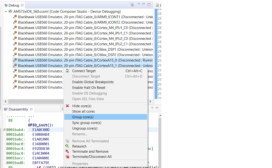

    I don't know the difference between "sync group cores" and "group cores", can you try if "group cores" work for you? Also, I need to find a AM574x IDK EVM for this test (typically we used AM572x IDK EVM). The EVM differs in processor, the issue you saw is caused by CCS.
    Can you clarify what CCS version you used? and what is the emulator?
    Regards, Eric
  • Hi Eric,
    I will try it, but it will be not work the cross-triggering if used the "group cores".
    I used the CCS v8.1, and emulator is on board emulator(XDS100v2).
    Best regards.
    Kaka
  • Hi
    When I used the Grope core, it showed the error as below.

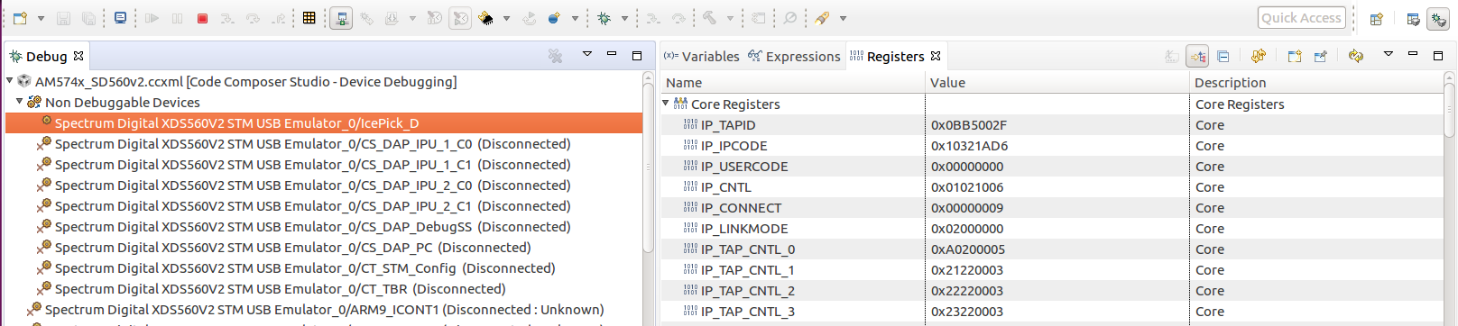

    I found an AM574x IDK EVM marked with AM5749IDK REV 1.0A. I used on-board xds100v2 USB emulator, and group A15_0 and A15_1 together, when connecting, I have:

    Which option did you select for group cores sync or only group?
    See below screenshot, there is "Group Core(s)", this is what I used.
    Regards, Eric

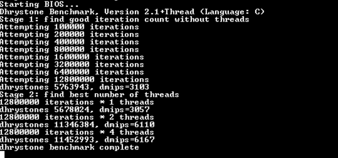

    The Dhrystone number looks right:
    Starting BIOS...
    Dhrystone Benchmark, Version 2.1+Thread (Language: C)
    Stage 1: find good iteration count without threads
    Attempting 100000 iterations
    Attempting 200000 iterations
    Attempting 400000 iterations
    Attempting 800000 iterations
    Attempting 1600000 iterations
    Attempting 3200000 iterations
    Attempting 6400000 iterations
    Attempting 12800000 iterations
    dhrystones 5763943, dmips=3103
    Stage 2: find best number of threads
    12800000 iterations * 1 threads
    dhrystones 5656343, dmips=3045
    12800000 iterations * 2 threads
    dhrystones 11346384, dmips=6110
    12800000 iterations * 4 threads
    dhrystones 11448689, dmips=6165
    dhrystone benchmark complete

  • Hi Eric, Rafael.
    I also found similar issue on AM574DIK. When I used the "Global Breakpoint" on A15 and M4 IPC project, it showed the same error as my previous post and the program did not stop even though other core stopped.
    Please confirm it just in case.
    1. Connect the A15_0
    2. Connect the IPU1 cores
    3. Select the A15_0 and IPU1 cores and set as grope core.
    4. Load program for A15_0
    5. Load program for the IPU1_C1
    6. Load program for the IPU1_C0
    7. Enabled the Global breakpoint all cores (A15 and IPU_C0)
       -< At this time, showed the error as below.
    8. Run the program at the same time.
    9. Stop the A15_0 or IPU1_C0
    -> At this time, the program did not stop at the other core.
    Just in case, here is the image which I used.
      6303.image.zip
    Best regards.
    Kaka
  • Kaka,
    Thanks to the dev team, they came up with a patch to CCS and I validated in both Windows and Linux on a DRA77xP EVM board (automotive version of the AM574x IDK).
    Please unzip the attached package to the c:\ti\ccsv8 directory and let it overwrite all the files -  the .zip file already contains the directory structure starting from ccs_base.
    One detail, though. Make sure your AM5748IDK board has a device populated with the proper ID. To get that information do the following:
    - Open a Debug session
    - Right click on the Debug view and click on "Show All Cores". A new branch called 'Non debuggable devices" will be shown.
    - Select the IcePick_D, right-click on it and select "Connect"
    - From the Registers view, expand the branch "Core Registers" and check the IP_TAPID entry. It should show 0x0BB5002F or 0x1BB5002F.
    This patch will be available in a future release of the TI Emulators component.
    Hope this helps,
    Rafael
    dbgtrc-3912.zip
