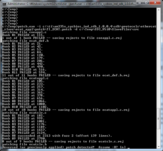

Where can I find instructions for compiling the full slave stack code for use with the AM335x ICE? My company is a memeber of the ETG and I have the SSC tool...

Scott,
for support with the SSC tool please ask ETG/Beckhoff.
We usually take the full source from the SSC src folder and do a patch. The patch files and descriptions are included with the SDK. See c:\ti\am335x_sysbios_ind_sdk_1.0.0.4\sdk\protocols\ethercat_slave\ecat_appl\patch\
SDK 1.0.0.4 works with SSC 5.01 sources. Then import the project and build...

Yes, it should say 5.01 in SSC release notes. SSC 5.0 works only with SDK 1.0.0.3.

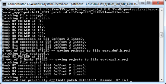

There is a delay on my end to get the latest SSC code until I have a form signed, so can I download the 03 version of the sdk somwhere to try running patch and building the application?

Scott,
did you try with a clean version of the SSC sources? I see you patch on the same folder as earlier so there might be two patches applied now.
Otherwise I have no clue.

As Mr. Walzer already mentioned the EtherCAT related directory structure and file names in the SDK changed from version 1.0.0.3 to 1.0.0.4.
For that reason the "TI AM335x Sample" configuration only works with the SDK version 1.0.0.3. Nevertheless I've create an SSC Tool project including the TI source files from SDK 1.0.0.4.
