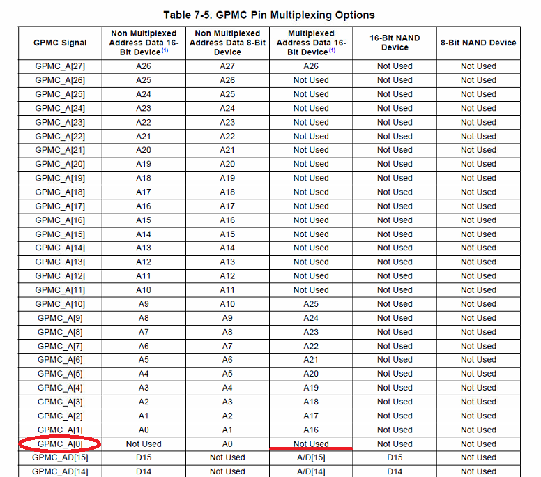

  • Why not just set GPMC_CONFIG1_0[DEVICESIZE]=0 (8-bit)?
  • 1) Table 7-5 in manual  spru73i.pdf, p. 269 implies multiplexed mode is available for 16-Bit devices only
    2) I checked it out: BE0 is fixed 0 and BE1 is fixed 1 now
  • I didn't realize you were using the multiplexed mode of operation.  The combination of "muxed" and "8-bit" does not appear to be one of the use cases envisioned by the designers.  This use case is therefore not validated or tested by TI.  Can you switch to non-multiplexed 8-bit interface so that you're using one of the supported modes?  That would be the safest approach.  There's a small risk that if you're using an unvalidated combination that there might be some kind of timing issue, e.g. you might only see it on extremes of process and/or temperature.

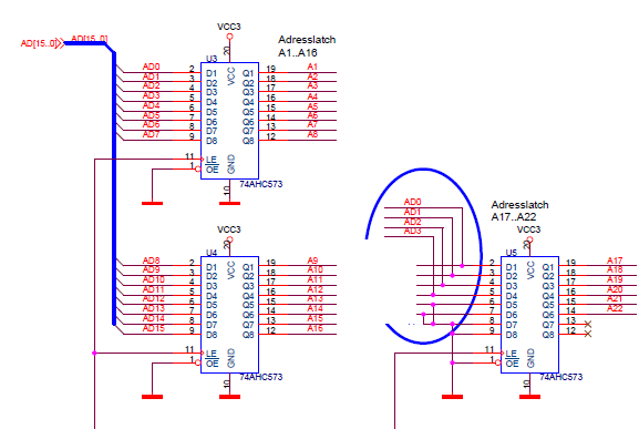

  • There are 3 different configurations related to multiplexing:
    • Non-multiplexed
    • Address-data multiplexed
    • Address-Address-Data Multiplexed
    Which of those are you trying to use?  And since 8-bit data is only officially supported with non-multiplexed configuration it sounds to me like you were trying to do something "creative" to utilize the 16-bit interface.  Is that correct?  Can you summarize how you were trying to use the 16-bit interface to connect to an 8-bit device?

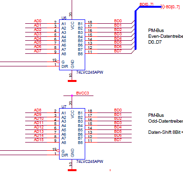

  • I use AAD-Muxed mode;
    This works fine with a 16Bit SRAM at CS1, AD[0..15]  as data, A[1..20] as address + BE0, BE1
    parallel I want to drive 8-bit periphery at CS2;  The gates and direction are driven by a PLD,
    depending on BE0, BE1, RD, WE;
    It works writing but not reading, cause BE0 and BE1 are not driven in read access.

  • Hi Nikolay,
    I decided to omit A0 and shift the address bus. Only byte accesses on even addresses are possible now
    ("holes" resp. mirrors are on odd byte addresses).
    This causes an ugly software, but in my case it will work (hopefully)

  • Hi Bastian,
    Thanks for reply.
    Today we have found an interesting thing. If configured. in mux 16 bit mode, pin GPMC_A0 as signal GPMC_A0 it allows to read the bytes from odd addresses, without shifting address. I know that it goes beyond the documentation, but for us it gives to debug drivers. Maybe it will help you.
    Nikolay Semko
  • Hi Nikolay,
    thanks for this great hint!
    Unfortunately I need this pin for the 2nd Ethernet port and I did not found an other pin mux possibility.
