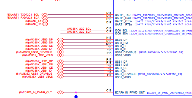

I'm working on customized am3359 board, which has same usb part schematic as beaglebone black A5C, I use uboot psp 06.00.00.00 and linux psp 04.06.00.11, after login root,  console outputs "ti81xx_interrupt 1146: VBUS error workaround (delay coming)" periodically and usb function can not work.

  • Can you check if you haven't pinmuxed USB_DRVVBUS to GPIO by accident? Can you post the USB part of your schematic? This error is caused by USB_VBUS pin being below minimum allowed voltage at session start.
  • I used original source code from TI web site, and did not modify any part of USB, only removed codes and configurations related to I2C0 to eeprom, I'm sure I did not  change USB_DRVVBUS setting from original codes.

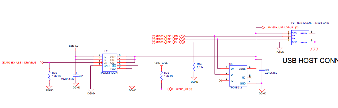

    Please move cap C21 to the place close to the usb port, for example, some where near C20, also increase C21 to 150uF, and let us if the issue still happens.
  • Hi, Liu Bin,
    I've removed U2 and connect U2 pin 2 to pin 8, used parallel two 100uF caps on C21 place(should about 200uF totally), and the actually distance between C22 to C21 is about 3~5mm. (to avoid any mistake, I've removed U3 too).
    This is my current situation, problem still happens, is there any suggestion for more testing?

    All your hw mod looks fine. That is equivalent to what I asked. But I cannot think of anything could cause the error. Following are some pointers I'd like you to try out. Maybe it will give us a clue.

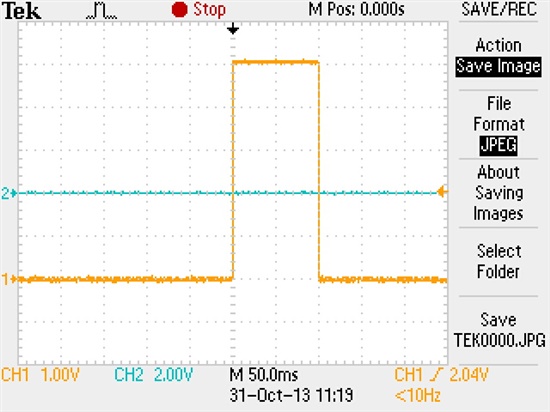

    How have you measured VBUS? using scope? Can you please use scope to measure both VBUS and DRVVBUS at the same time and provide the screenshot?
    Yes, now I connect VBUS directly to system 5V, I use Tektronix TDS2024G to get below screenshot.

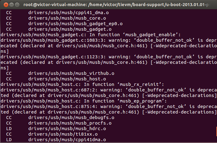

  • Additionally, I found some kernel build warning related to usb:
    Is it risky?
    I also attached some boot log for your reference.

    2. Please provide you modified board-am335xevm.c, I want check your code change;
    3. By the way, the kernel build warnings are not issue at all;

    I will look into more on this tomorrow, in meantime could you please provide the USB0 part of your schematics?
    USB0 related pins are floated and not connected to anything yet (includes connectors and res/cap).

    You plugged the usb-stick to USB1 not USB0, right?
    Can you please post the USB0 part of the schematics?
  • Yes, surely plug into USB1.
    USB0 singals are not layed out.

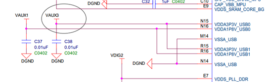

  • Yonghui,
    It seems you did follow the exact procedure when you capture the log debug-vbuserror.log (there is no message for 'cat /proc/...'), but it is not a big deal. My only question for the log is that did you plug a usb device on USB1 port when capturing the log?
    USB0 is not layed out, but do you have VDDA1P8V_USB0 and VDDA3P3V_USB0 pins connected to the power rails? If not, are those pins brought out then can be connected?

    VDDA1P8V_USB0 and VDDA3P3V_USB0 should be powered correctly (connecting to TPS65217C's LDO3 and LDO4 separately), I'll check the actual voltage tomorrow.

  • Liu Bin,
    I've modified USB part hardware and board-am335xevm.c back, patched your file to my kernel, now the flood of warnings disappear, only saw once before login.
    But not usb still can not enumerate, I checked DRVVBUS line, when usb stick is plugging in, it keeps low, same as VBUS, seems USB part does not know usb device is plugged in. I noticed that, when powering on, if usb stick is plugged in, it twinkles once.
    I've made same testing as before, please check below files. log
