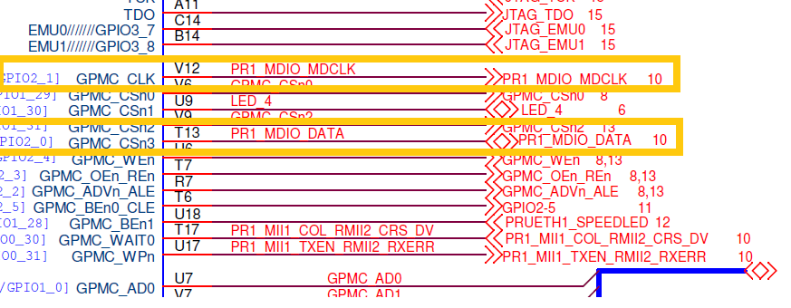

  • I've just had the same issue.
    In my case, problem is caused by MDIO interface hardwiring:
    In ethernet configuration, only MDIO_CLK and MDIO_DATA should drive PRUETH_MDC and PRUETH_MDIO.
    But, if you run ethernet application through CCS debugger (and JTAG download cable), CPU configured PR1_MDIO_MDCLK  and PR1_MDIO_DATA according to preloaded ethercat application loaded by the bootloader *before* CCS debugger even connected to CPU:
    GEL init script does not disable PRU or its pinmux, so you get two output pins driving the same net.
    To avoid this, you should disconnect those two pins from PRU and configure as tristate, before any MDIO init in ethernet application (ie: enetLwip_sysbios):
    	GPIOInit();
        prot_mutex_hdl = GateMutex_create(NULL, NULL);
    	CPSWPinMuxSetup_Ind();
    	/*GPIO2_0 input: if PRU is still driving PR1_MDIO_MDCLK, override this  */
     	HWREG(SOC_CONTROL_REGS + CONTROL_CONF_GPMC_CLK) = 0x07;		// pinmux
     	HWREG(SOC_GPIO_2_REGS + 0x134) |= (1 << 0);					// input gpio2_0
     	/*GPIO2_1 input: if PRU is still driving PR1_MDIO_DATA, override this */
     	HWREG(SOC_CONTROL_REGS + CONTROL_CONF_GPMC_CSN(3)) = 0x07;	// pinmux
     	HWREG(SOC_GPIO_2_REGS + 0x134) |= (1 << 1);					// input gpio2_1
    	if(AM335X_BOARD_TYPE_ICE_V2 == boardType)
    		UTILsInitCpswIcssPorts(CPSW_SWITCH);
        CPSWClkEnable();
    	MDIOInit(SOC_CPSW_MDIO_REGS,400,5);
