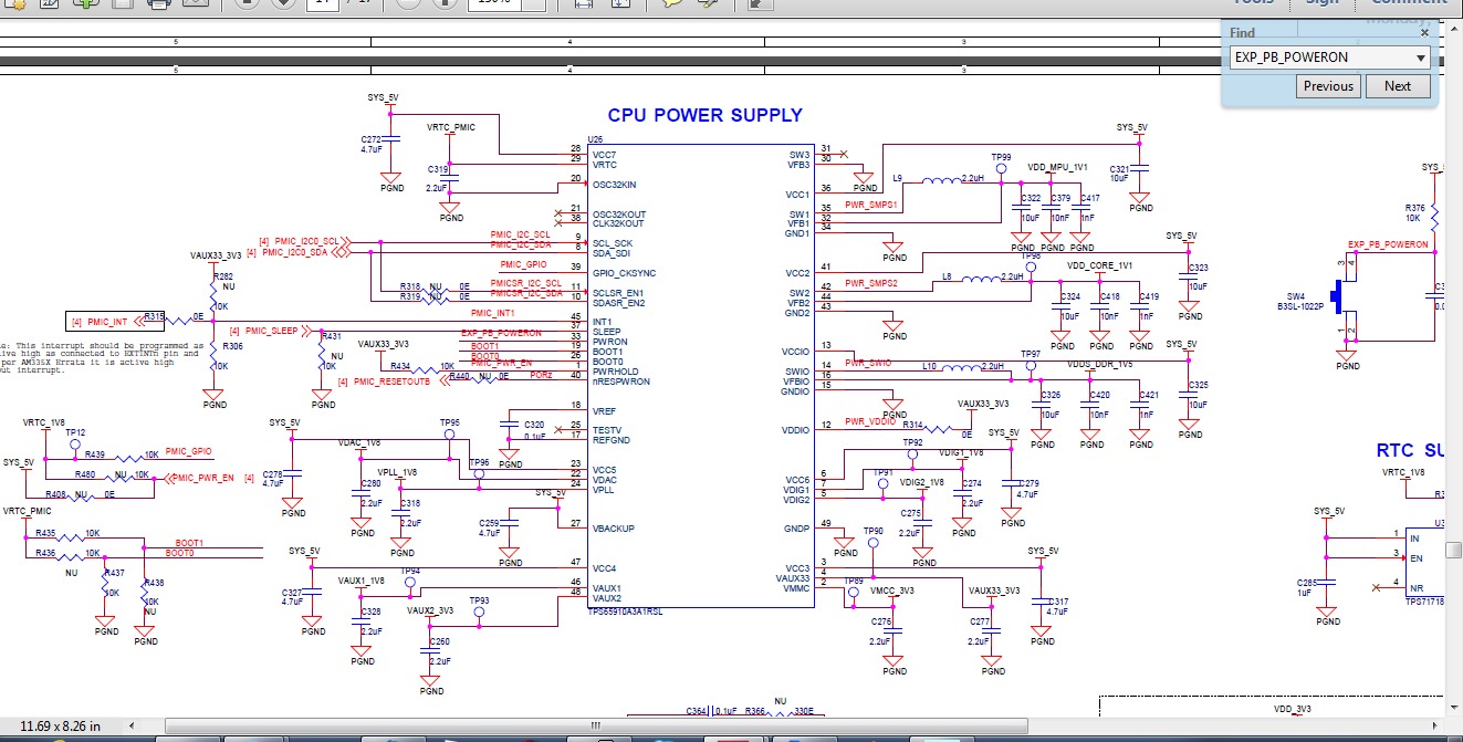

  • Hi Biser,
    In our custom design we have provided power button which connects PWRON pin of the PMIC. But if press for more then 8 seconds, instead of power off, board gets reset.
    I have also tried it using software command but in that case also board gets reset.
    I am attaching the diagram of PMIC connection with the processor. Can you help us to verify if we are missing anything ?
    Thanks and regards,
    Shabbir Limdiwala
  • Hi Biser,
    We have made connection according to the user guide you mentioned and also match with sitara evm design. But still it's not behaving as per sitara evm.
    It would be really appreciable if you can look at it once that what we are still missing ?
    Thanks and Regards,
    Shabbir Limdiwala
