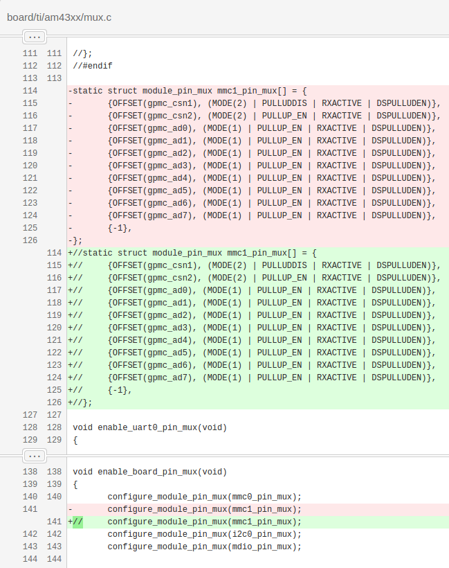

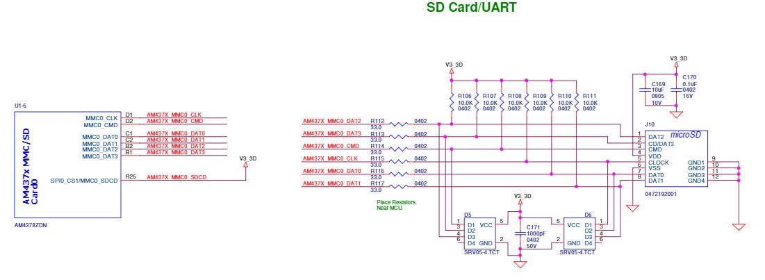

We're using an AM437x processor on a custom board, and our U-boot is getting stuck at the following line:
[    2.460489] Waiting for root device /dev/mmcblk0p2...
Since this was not happening on our other dev boards, we investigated any hardware changes made to the uSD card connector.  The only major difference is that our new connector does not have a card detection and our MPU pin R25 is pulled up to 3.3V.
This U-BOOT patch from 2011 http://lists.denx.de/pipermail/u-boot/2011-December/112202.html states that the MMC_getcd() function is no longer used and it will always return -1 which mean the card detection mechanism is no longer implemented in u-boot.  This was the latest update we saw based on our research that pertains to the card detection function.  Although these findings imply that our hardware change to the card detect is not the culprit, we do see that there are many responses still implying that the problem lies somewhere with this card detect signal.
Is there any solution to this problem?

  • Trent, can you send us the MMC/SD portion of the schematic, from AM437x out to the card?

  • Hi Trent, thanks for the schematic. A few things to try and some questions:
    -What is the approximate distance from AM437x to the card cage?
    -The is a note in the schematic to place the series resistors close to AM437x. Can you confirm that this is true, especially for MMC_CLK?
    -Really the only series resistor needed is for MMC_CLK. Keep the 33ohm on MMC_CLK and replace the others with 0ohm. Also, remove the pullup on MMC_CLK. This will get us closer to the EVM schematic which we haven't had any issues with.

    Thanks for the input.  I am looking into the software errors right now.   All of this makes sense because our older boards that booted linux had eMMC installed on the  GPMC pins.  But then we removed the eMMC and decided to utilize the sd card as a boot device AND general purpose for the end user.  I am currently having problems trying to upload a screenshot of our old eMMC interface but I can show you below which pins were connected to what:
    AM4378 B5/A5/B6/A6/B7/A7/C8/B8<-> eMMC DAT0-7
    AM4378 B9 -> 22Ohm Resistor -> eMMC CLK
    AM4378 F10 -> 10K pullup to 3.3V -> eMMC CMD
    Like I stated before these pins are no longer connected to anything on the new boards that are having problems.
    I have already made the following changes to board/ti/am43xx/mux.c to disable the MMC1 muxing for our older boards.
    Trent
