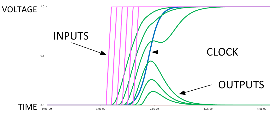

    An input to a synchronous circuit (meaning one operating on a clock signal) needs to be valid 0 or valid 1 during some window of time during each clock cycle (indicated by the "setup time" and "hold time") to ensure it is sampled correctly. If the input is transitions during this window of time then the flip-flop starts having trouble deciding:
     (click to zoom)
    This image (from Metastability and Synchronizers — A Tutorial) shows how the output varies depending on the timing of a transition of the input signal (relative to the clock). You notice that the output may briefly hover near the center briefly before settling to 0 or 1. In fact if the input edge is sufficiently ill-timed, the flip-flop cannot decide and ends up in a metastable state, balancing on the edge until random influences finally push it over.
    Metastability is generally highly undesirable in digital logic: functional behaviour of the rest of the circuit may become unpredictable, and power consumption increases greatly (in some cases leading to destruction). To deal with this, special synchronization circuits are needed.
    A very common structure consists of two consecutive flip-flops: the first may go occasionally go metastable, but it is designed to ensure its output will settle in time for the second flip-flop to sample it safely. This is ultimately the origin of the "two pulses" requirement you mention.
    Note that these things are all over the SoC, really lots of them (the cortex-A8 interrupt controller alone has 128 synchronizers: one for each irq input), but all clock signals are sufficiently fast that you'd never notice except by careful timing tests.  However, if you select TCLKIN as the functional clock for a timer, but instead of a clock you send individual pulses, such delays can suddenly become highly visible.
