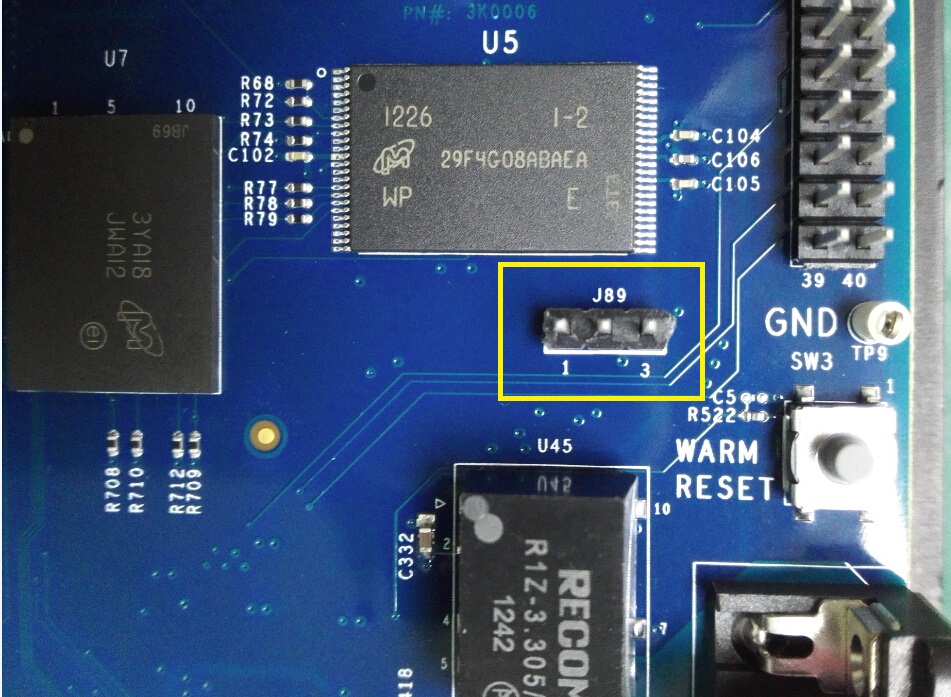

Hi experts,
I'm using TI AM437x GP EVM Rev 1.2A board, there is an eMMC chip MTFC4GLDDQ-4M IT on board, however, I can not access it from U-BOOT, it report following error message,

  • I believe you need to jumper pins 1-2 of header J2 to enable the eMMC. The NAND is enabled by default. Or, you could could set GPIO24, ball T23 to high to accomplish the same thing.
    This may depend on the version of the board that you have.
    Sorry I can't try it right now as I don't have a jumper handy.
    I'm using TI AM437x GP EVM Rev 1.2A, I also found the mathing sch for Install jumper to 1-2 of J89, However, it still report 'Card did not respond to voltage select!'

    Below is my board's picture,
    Or could you please let me know if the eMMC has ever working under uboot or Linux?

  • Hi wu shengjiang
    Thanks for the reply.Link provided helped me getting the clarity am437x GP EVM of Rev1.4A has no boot mode from eMMC.
