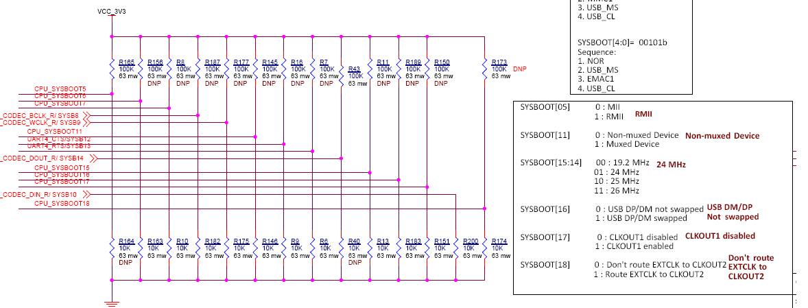

    3. Consider CTRL_STS[25]SYSBOOT17 bit, check if your code modifies this bit. Check Section 5.2.5.2 SYSBOOT Configuration Pins, paragraph after Table 5-10. SYSBOOT Configuration Pins (continued) in device TRM, for more details.
    >> Here sysboot configuration is defined in hardware and we are not controlling these pins via software or code. As per our HW design by default sysboot configuration have disabled   CTRL_STS[25]SYSBOOT17 bit :
