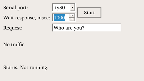

  • build in example in qt5 and when use QT += serialport i found error  " unknown module(s) in QT "
    you can check that link :
    doc.qt.io/.../qtserialport-blockingmaster-example.html

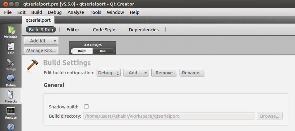

  • I built the blockingmaster example with this approach.
    Follow these steps and export the Qt5 environment variables along the SDK 01.00.00.03.
    In a new terminal execute these commands:
    $ ln -s ~/ti-processor-sdk-linux-am335x-evm-01.00.00.03/linux-devkit/sysroots/cortexa8t2hf-vfp-neon-linux-gnueabi/usr/lib/qt5/mkspecs/linux-g++ ~/ti-processor-sdk-linux-am335x-evm-01.00.00.03/linux-devkit/sysroots/cortexa8t2hf-vfp-neon-linux-gnueabi/usr/lib/qt5/mkspecs/default
    $ git clone git://code.qt.io/qt/qtserialport.git
    $ cd qtserialport
    $ git checkout v5.5.0
    $ ls
    examples LGPL_EXCEPTION.txt LICENSE.FDL LICENSE.GPL LICENSE.LGPL qtserialport.pro README src sync.profile tests
    In your case am335x should be am437x.
    Open the qtserialport.pro project file with the qtcreator.
    $ source ~/ti-processor-sdk-linux-am335x-evm-01.00.00.03/linux-devkit/environment-setup
    $ ./qtcreator
    Disable the shadowing.

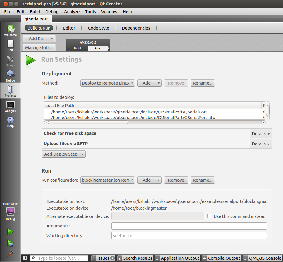

    Add the following lines:
    target.path += /home/root
    INSTALLS += target
    to
    blockingmaster.pro
    target.path += /usr/lib
    INSTALLS += target
    to
    serialport.pro
    Set the run configuration to blockingmaster.
    Run the configuration and it you'll see the blockingmaster example running on your kit.
