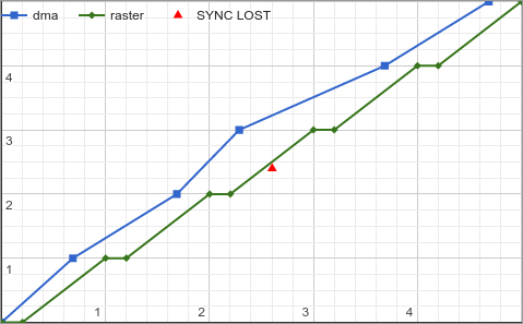

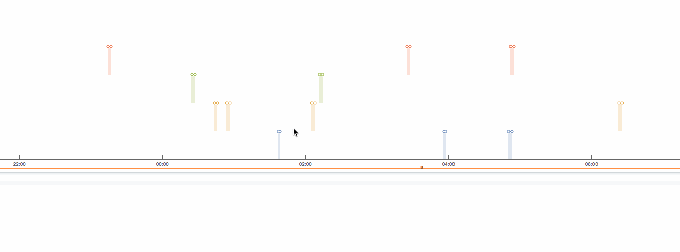

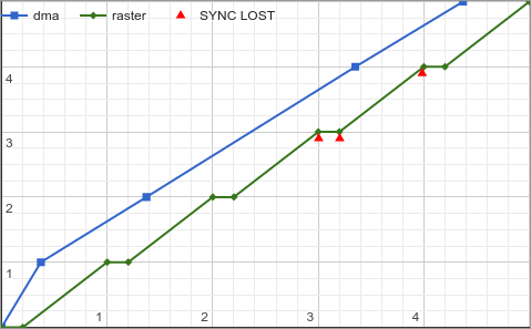

    We also are a bit of a loss on how to reproduce, we are currently set up a farm of 8-16 devices with a camera pointed to be able to A/B test with. We have a build with 3.14.43 that we are currently testing. We still have the issue that sgx_flip_test doesn't work out of the box (it does when we bump DRM_NUM_FBDEV_BUFFERS to 4 like described here: https://e2e.ti.com/support/arm/sitara_arm/f/791/t/438583 , but the graphical glitches still happen).
    A colleague wrote a tool that displays the content of fb0 (I can send you the dumps in a private email as the content is not public for now). fbset -i reports enough for 3 buffers, however due to alignment the fb0 seems to contain only 2. (please note the the whitespace is part of the image)
    When running with BLITWSEGL, the content is the following:
    My suspicion is that FLIPWSEGL doesn't realize that the allocated framebuffer memory (by drm_fb_cma_helper.c ) is not enough to fit 3 aligned buffers, and writes over the boundaries, leading to the spurious issues.
    Do you know how FLIPWSEGL communicates the memory region to the GPU, and if the GPU could access non-cma-ed memory?
    When bumping DRM_NUM_FBDEV_BUFFERS to 4, sgx_flip_test works, and when running the UI with FLIPWSEGL, /dev/fb0 contains 3 copies of the display. I suspect that in this case, FLIPWSEGL thinks it has room for 4 copies of the buffer, and again writes over the allocated boundaries.
    This is turning into a critical problem for us, more testing will be done in the following days.

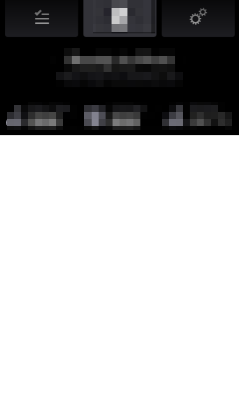

  • Here is a video of the glitches happening. Usually the UI comes back to normal, and the function of the machine is not affected, but sometimes the kernel starts outputting a lot of messages and the system bogs down to a halt. If you look closely, you can see the "real UI" flash by on certain frames (at 0:09 for example).

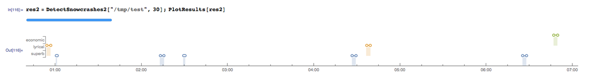

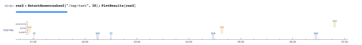

    literategoat
    [ 5403.878240] tilcdc 4830e000.lcdc: tilcdc_crtc_irq: snowcrash?  stat: 00000004
    [ 5403.895962] tilcdc 4830e000.lcdc: tilcdc_crtc_irq: snowcrash?  stat: 00000004
    [ 5403.913656] tilcdc 4830e000.lcdc: tilcdc_crtc_irq: snowcrash?  stat: 00000004
    economicbush
    [41849.267241] tilcdc 4830e000.lcdc: tilcdc_crtc_irq: snowcrash?  stat: 00000004
    [41849.284951] tilcdc 4830e000.lcdc: tilcdc_crtc_irq: snowcrash?  stat: 00000004
    [41849.302661] tilcdc 4830e000.lcdc: tilcdc_crtc_irq: snowcrash?  stat: 00000004
    [41849.320379] tilcdc 4830e000.lcdc: tilcdc_crtc_irq: snowcrash?  stat: 00000004
    [41849.338087] tilcdc 4830e000.lcdc: tilcdc_crtc_irq: snowcrash?  stat: 00000004
    [41849.355813] tilcdc 4830e000.lcdc: tilcdc_crtc_irq: snowcrash?  stat: 00000004
    [41849.373521] tilcdc 4830e000.lcdc: tilcdc_crtc_irq: snowcrash?  stat: 00000004
    [41849.391242] tilcdc 4830e000.lcdc: tilcdc_crtc_irq: snowcrash?  stat: 00000004
    [41849.408948] tilcdc 4830e000.lcdc: tilcdc_crtc_irq: snowcrash?  stat: 00000004
    [41849.423181] tilcdc 4830e000.lcdc: tilcdc_crtc_irq: snowcrash?  stat: 00000004
    lyricalshark
    [33991.289131] tilcdc 4830e000.lcdc: tilcdc_crtc_irq: snowcrash?  stat: 00000004
    [33991.306844] tilcdc 4830e000.lcdc: tilcdc_crtc_irq: snowcrash?  stat: 00000004
    [33991.324557] tilcdc 4830e000.lcdc: tilcdc_crtc_irq: snowcrash?  stat: 00000004
    [33991.342271] tilcdc 4830e000.lcdc: tilcdc_crtc_irq: snowcrash?  stat: 00000004
    [33991.359995] tilcdc 4830e000.lcdc: tilcdc_crtc_irq: snowcrash?  stat: 00000004
    [33991.377707] tilcdc 4830e000.lcdc: tilcdc_crtc_irq: snowcrash?  stat: 00000004
    [33991.395426] tilcdc 4830e000.lcdc: tilcdc_crtc_irq: snowcrash?  stat: 00000004
    [33991.413133] tilcdc 4830e000.lcdc: tilcdc_crtc_irq: snowcrash?  stat: 00000004
    [33991.430839] tilcdc 4830e000.lcdc: tilcdc_crtc_irq: snowcrash?  stat: 00000004
    [33991.445087] tilcdc 4830e000.lcdc: tilcdc_crtc_irq: snowcrash?  stat: 00000004
    superbanteater
    [40458.114179] tilcdc 4830e000.lcdc: tilcdc_crtc_irq: snowcrash?  stat: 00000004
    [40458.131912] tilcdc 4830e000.lcdc: tilcdc_crtc_irq: snowcrash?  stat: 00000004
    [40458.149602] tilcdc 4830e000.lcdc: tilcdc_crtc_irq: snowcrash?  stat: 00000004
    [40458.167319] tilcdc 4830e000.lcdc: tilcdc_crtc_irq: snowcrash?  stat: 00000004
    [40458.185035] tilcdc 4830e000.lcdc: tilcdc_crtc_irq: snowcrash?  stat: 00000004
    [40458.202748] tilcdc 4830e000.lcdc: tilcdc_crtc_irq: snowcrash?  stat: 00000004
    [40458.216978] tilcdc 4830e000.lcdc: tilcdc_crtc_irq: snowcrash?  stat: 00000004
    [47706.280239] tilcdc 4830e000.lcdc: tilcdc_crtc_irq: snowcrash?  stat: 00000004
    [47706.297951] tilcdc 4830e000.lcdc: tilcdc_crtc_irq: snowcrash?  stat: 00000004
    [47706.315661] tilcdc 4830e000.lcdc: tilcdc_crtc_irq: snowcrash?  stat: 00000004

    We have investigated a bit in the tilcdc_drm driver, and I think I possibly have an idea where the bug might, but need more investigation. We also reverted to the old da8xx-fb.c driver from the 3.12 branch (forward ported to 3.14), and are in the process of testing it overnight. But we are not too confident as we capture something that looks like a snowcrash.
    These are the runs of our image recognition software. This is a standard 3.14 kernel with FLIPWSEGL, tilcdc-drm and SDK 5.01.01.02:
    We then modified tilcdc_drm to printk when a single LOST_SYNC interrupt was happening, we got less snowcrashes (maybe because we handled that interrupt, but without resetting the raster engine), but in any case:
    This is tilcdc_drm with FRONTWSEGL (the signals at the start and end is when we restarted the UI.
    And this is fbdev without FRONTWSEGL (again, only hits when we restarted the UI):
    And just because it looks so pretty, here is a few of those lost sync sequences:
    Hope this might help you to take further steps on your side.

    BTW, it appears LCDC does in fact make a shadow copy of the buffer end-pointer: I've been unable to trigger a SYNC-LOST by updating both sets of pointers while DMA was running. It still seems like bizarrely bad luck to strike in between two stores, but there's a really easy way to prevent it: use a 64-bit store to write both fields at the same time. The L3 interconnect will still break it up into two 32-bit stores, but at least you exclude the possibility of an interrupt inbetween.
    If such a store is done at an arbitrary time rather than in response to an EOF interrupt there's still some risk though that LCDC switches to the new buffer precisely in between those two 32-bit stores. As mentioned before, the simple solution is to only update the pointers in response to an EOF interrupt.
    W.r.t. sync-lost recovery, here's what happens if a single frame has only half the expected size or double the expected size:
    In case of a short framebuffer the raster engine emits a sync-lost upon encountering the unexpected end. The raster timing remains unaffected though, so I wonder what it's outputting... (note: there's a mistake in the first picture since the short framebuffer should make the total data transferred increase by only 1/2 frame worth of data. Once fixed that will place the dma-line below the framebuffer line: the raster engine must be outputting something, but not data from dma.)
    In case of a long framebuffer I get three sync-lost irqs: one right after it expected end of buffer but didn't get one, then after the vertical blanking period it complains again, presumably about the lack of start-of-buffer indicator. I have no idea why it's complaining the third time: there should be an end-of-buffer marker there. In this situation both frame timing and dma rate appears unaffected (this might however be due to lack of data points. I manually edited in the vertical blanking periods; dma would show similar shape of course, but 2 KB later).
    Horizontal axis is in frame-times, vertical in frames worth of data.

  • And sadly... we saw a snowcrash on one of the machines we rolled out the patch to. This is not yet our webcam monitoring setup, but we had a plethora of SYNC LOSTs in the logs. The machine wasn't even under heavy load.
    Which leads me to wonder what actually is causing the sync lost. Here is the state of my (limited) knowledge: the reason a sync lost happens is due to the DMA registers being wrong at *exactly* the time a VBLANK interrupt happens, leading for the LCDC DMA engine to end up latching in a wrong pair of registers, with the floor register pointing to the new buffer, and ceil still pointing to the old buffer (in the order we do our writes). Is the only correct way to do this correctly using an atomic 64 bit write to write to both registers at once? Does the interconnect/LCD controller allow for that?
    But this explanation confuses me. The fact that Tomi's patch uses only one channel, that is written to inside a spinlock_irqsave, on a non-RT kernel, with a safety interval after the previous VBLANK, makes it hard to me to understand how the above race condition happens (and I think it has to happen not once, because the LCDC seems to recover after a single SYNC LOST, but multiple times in a row). Here is my tentative explanation: the VBLANK interrupt gets handled late (around 3ms if we assume the 60 fps), which leads the page_flip method which runs at a later time (say 14 ms) to write to the dma registers inside the danger time interval. As far as I can tell, page_flip however is going to be called from that same irq handler through the vblank_callback handler leading into omaplfb, which makes the 14 ms delay there very improbable. That the VBLANK irq gets serviced 16.67 ms late also seems improbable (?).
    We do indeed have a high load of i2c interrupts at all times because of sensors we have to poll. But we don't see a really bad increase in timing variability at all.
