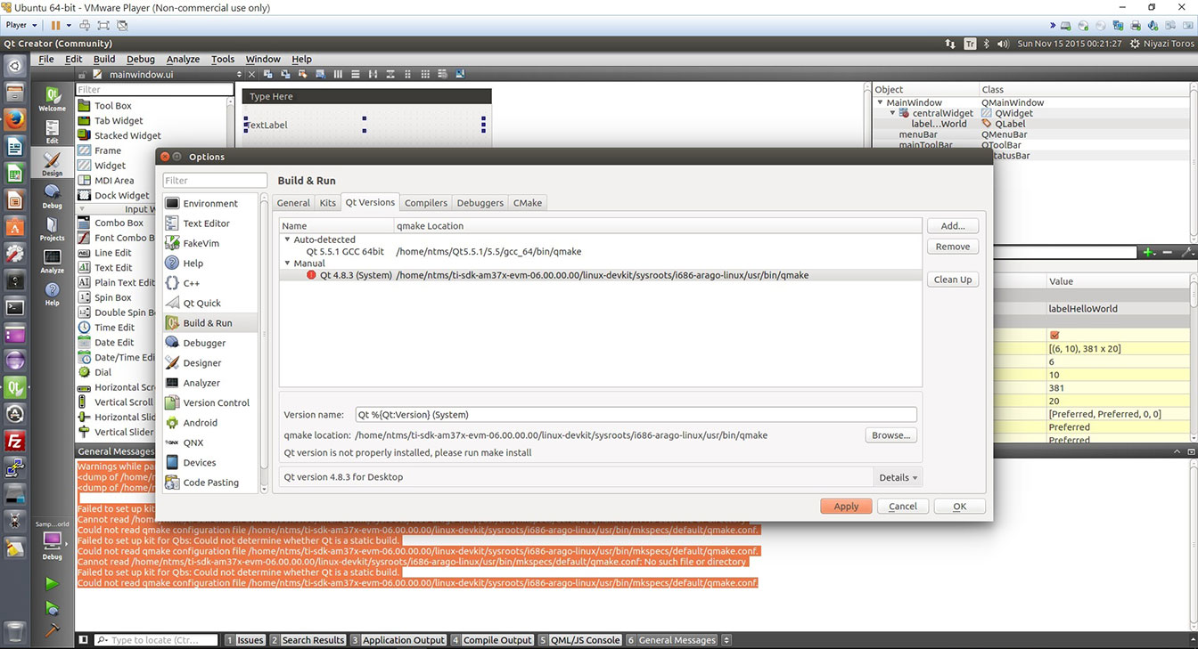

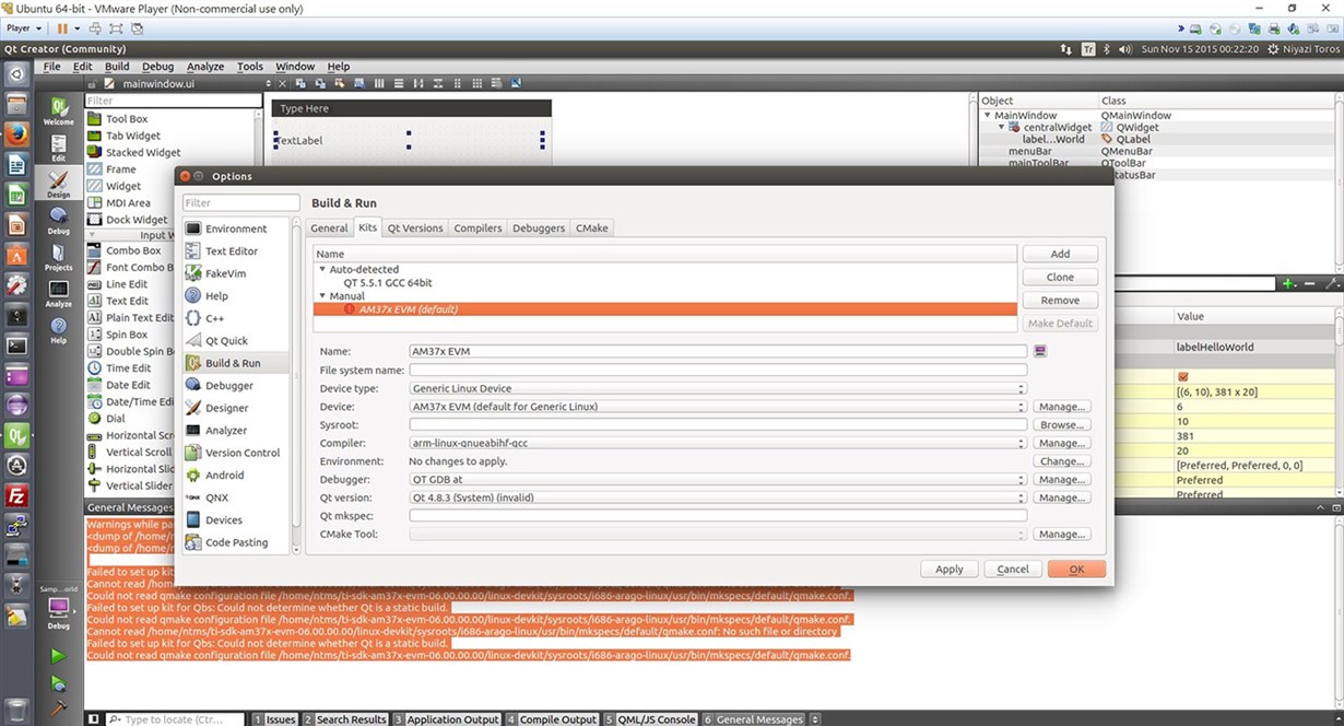

  • Thank you, but no luck. In QT Kits tab in Auto-detected is QT 5.5.1 GCC 64bit and my configuration of Under Manual is AM37xEVM. I also set my one as default. But on bottom left corner the PC icon I can see only Auto-detected kits wich is QT 5.5.1 GCC 64bit.
    Here is a pictures of my settings.
    Kind Regards

    But I already have Qt Creator 3.5.1 (opensource) (QT Version.
    :( Why is asking me that 'qtcreator' is not installed. ?????
    Here is my QT folder: /opt/Qt5.5.1. I did this installation using one of the QT help form.
  • This is not a concern. Just paste the absolute path to your qtcreator.
    <Qt install dir>/Tools/qtcreator-3.5.1/bin/qtcreator
  • Thank you. I did. But still shows me wrong configuration of the kit.

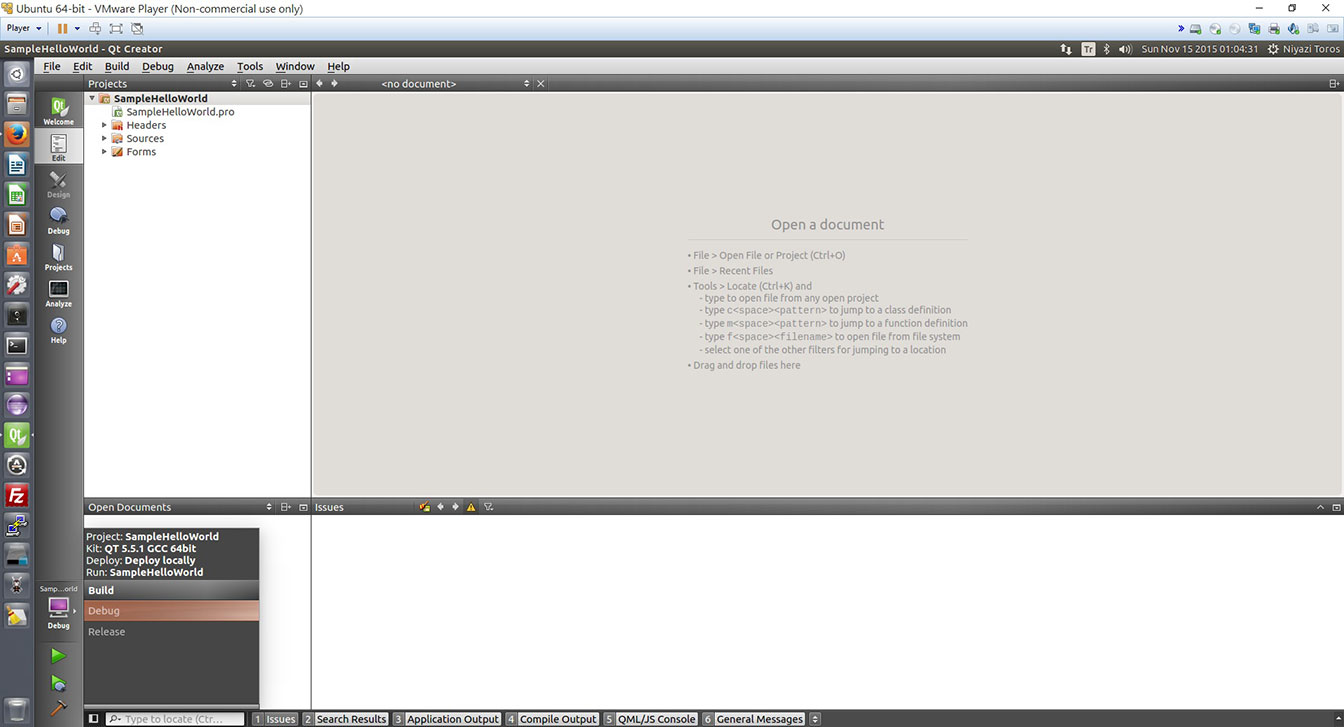

    When I try to build I get an error:
    /home/ntms/SampleHelloWorld/mainwindow.cpp:2: In file included from ../SampleHelloWorld/mainwindow.cpp:2:0:
    /home/ntms/SampleHelloWorld/ui_mainwindow.h:13: error: QtGui/QAction: No such file or directory
     #include <QtGui/QAction>
    In terminal:
    ntms@ubuntu:~$ source /home/ntms/ti-sdk-am37x-evm-06.00.00.00/linux-devkit/environment-setup
    [linux-devkit]:~> /opt/Qt5.5.1/Tools/QtCreator/bin/qtcreator
    QByteArray ProjectExplorer::runGcc(const Utils::FileName&, const QStringList&, const QStringList&): "/home/ntms/ti-sdk-am37x-evm-06.00.00.00/linux-devkit/sysroots/i686-arago-linux/usr/bin/arm-linux-gnueabihf-gcc" "-xc++ -E -dM -" returned exit code 127: "/home/ntms/ti-sdk-am37x-evm-06.00.00.00/linux-devkit/sysroots/i686-arago-linux/usr/bin/arm-linux-gnueabihf-gcc: error while loading shared libraries: libstdc++.so.6: cannot open shared object file: No such file or directory\n"
    QByteArray ProjectExplorer::runGcc(const Utils::FileName&, const QStringList&, const QStringList&): "/home/ntms/ti-sdk-am37x-evm-06.00.00.00/linux-devkit/sysroots/i686-arago-linux/usr/bin/arm-linux-gnueabihf-gcc" "-dumpmachine" returned exit code 127: "/home/ntms/ti-sdk-am37x-evm-06.00.00.00/linux-devkit/sysroots/i686-arago-linux/usr/bin/arm-linux-gnueabihf-gcc: error while loading shared libraries: libstdc++.so.6: cannot open shared object file: No such file or directory\n"
