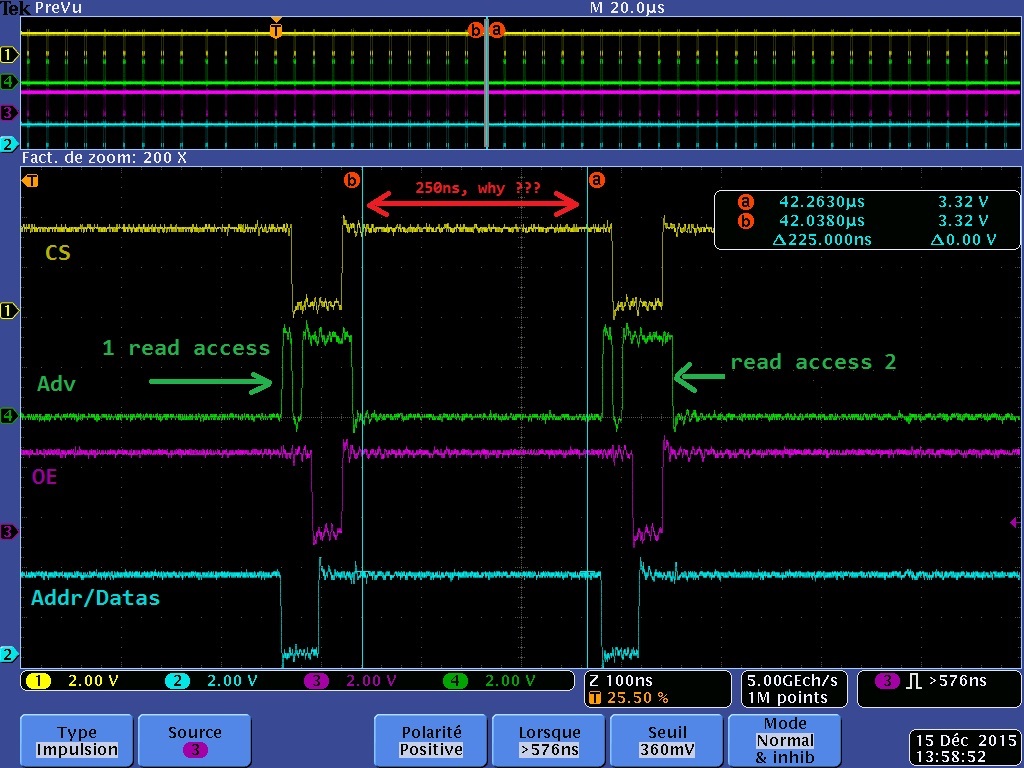

I am using a am3359 processor interfaced with a fpga.
I have write a fpga driver to initialize the Gpmc bus: Cs0, Nor flash like, asynchronous, 16 bits, address and data multiplexed, no wait pin.
It's ok now to read and write datas. We have improved the timing by using a scope: 60ns for an word read access and 40ns for a write access.
My problem: if i make two consecutly access ( 2reads or 2 write), impossible to decrease the duration between two access: this operation take 250ns.
My code :
volatile unsigned short toto;
toto =  (*((volatile unsigned short *)( FPGA_CS0_BASEADDR + offset)));
The result (scope), you can the the 'bad' delay : 250ns
It's very important for me to optimize the read access (get a 64 bits value in fpga registers in 4 read access)
I have tried to decrease the GPMC_CONFIG6_0 field value without success..

    You can speed up performance if you use DMA. there is a good post on this topic here: e2e.ti.com/.../348712
  • Thank Biser,
    First : Do you think that this long delay was a standart delay ? Is it a normal behaviour with a 100Mhz clock ?
    Secund : Enable the Dma function seems to be a solution, but I need more time to develop It.
    A question : If I need to read 1 and 4 words access (small datas), that implies to configure differently the size of the prefetch for each access.
    I am not sure that this operation doesn't increase the time, do you think that the code/operation ratio is good and lower than 200ns ?
    JM
  • The delay between accesses has nothing to do with the GPMC clock speed, it's due to internal processor latencies. I agree that for small data blocks (1 to 4 words) you will see no big improvement if you use DMA. You might want to try Asynchronous read page access (4-8-16 Word16). See section 7.1.3.3.10.3.3 from the AM335X TRM Rev. L.

  • The 250ns is the bus arbitration time. Its done for each bus transfer.
    You might be able to have this arbitration seldom, by using a FIFO behind your ADC, and using DMA to transfer big chunks of data.
