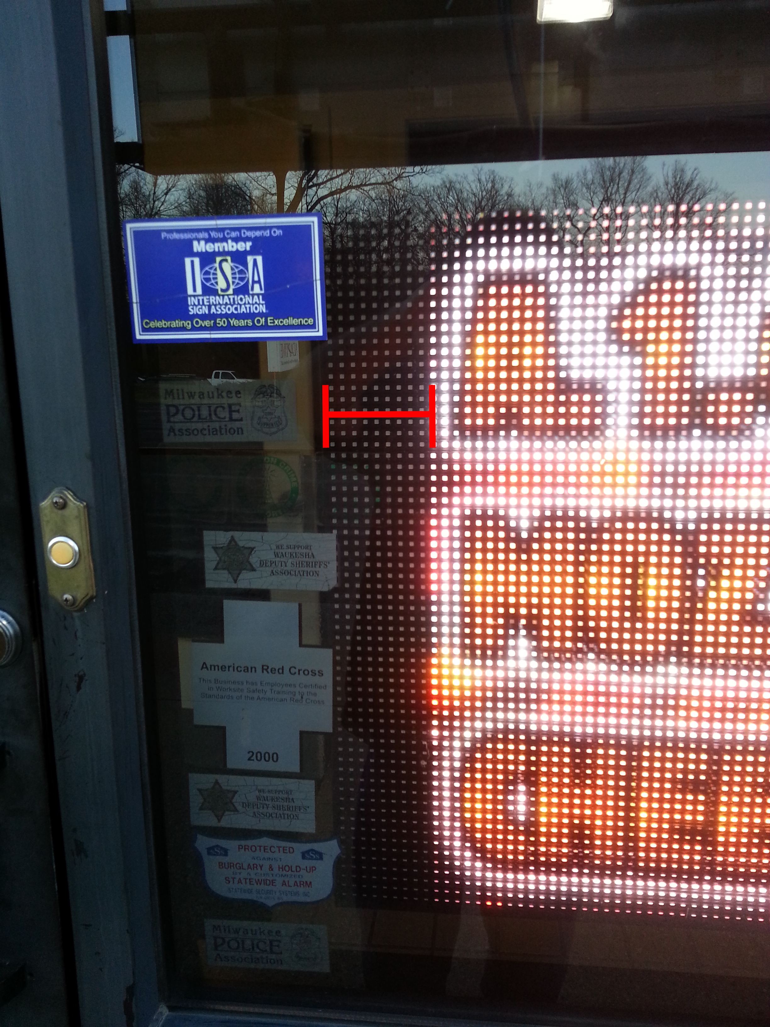

We are currently experiencing an issue where the display of our sign is shifted to the right. It seems to occur randomly, with a random number of pixels, for random durations. The shift has been between 4 to 16 pixels. It can be 30s or shorter and up to several hours. Eventually the sign recovers and begins displaying normally. During the issue the video being played back runs normally, it is just shifted off the display.
You can see in the above image that our display is shifted to the right by 9 pixels. Our application uses the DRM to allocate space for drawing on a panel 800x600. It should be drawing at the orgin, not shifted over. Our video signals are connected directly to our FPGA with which we drive LED tiles. We are running 24 bit color. We are currently using the kernel provided with SDK 8 release. This is kernel 3.14.26.

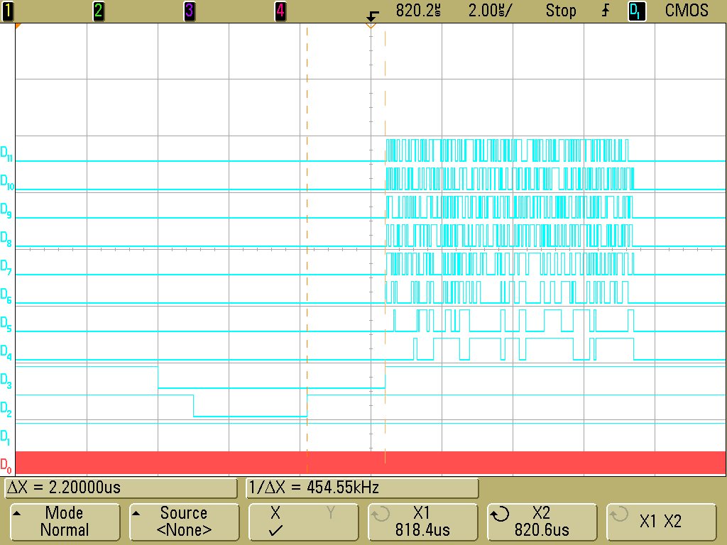

We were able to capture video timings while the display was not shifted

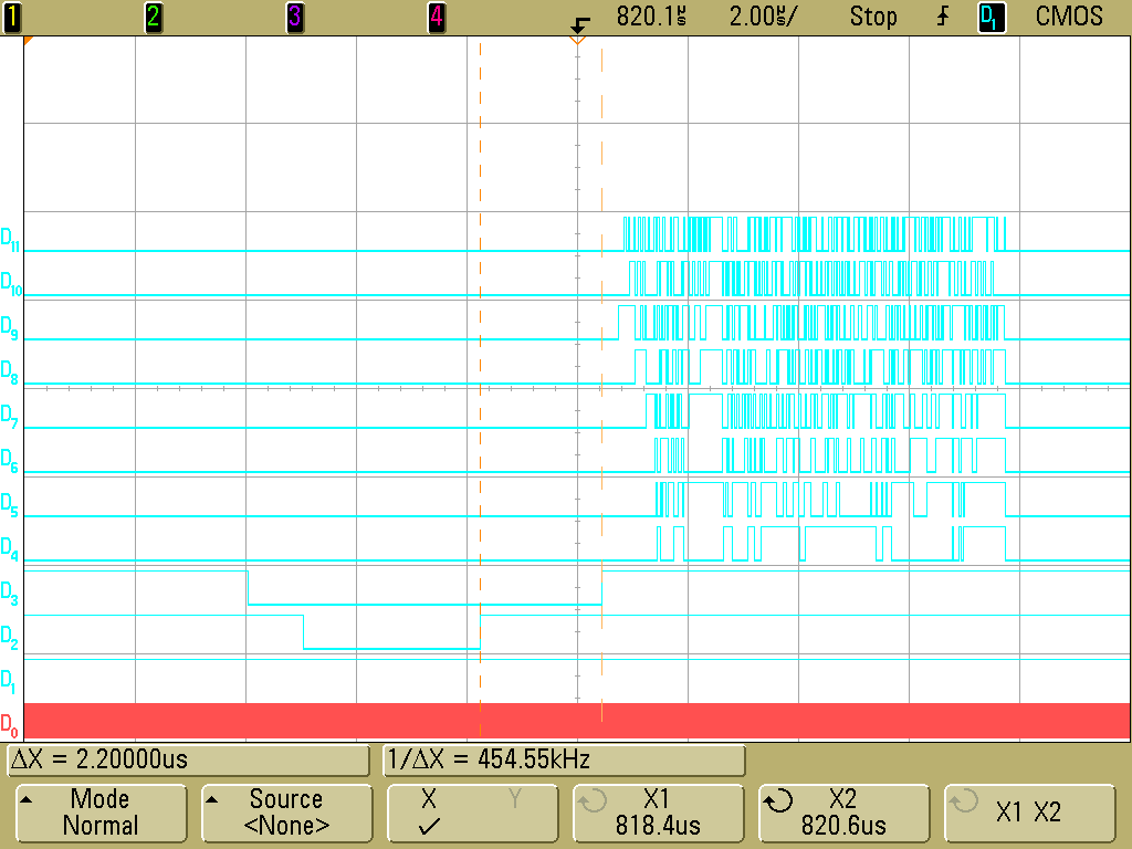

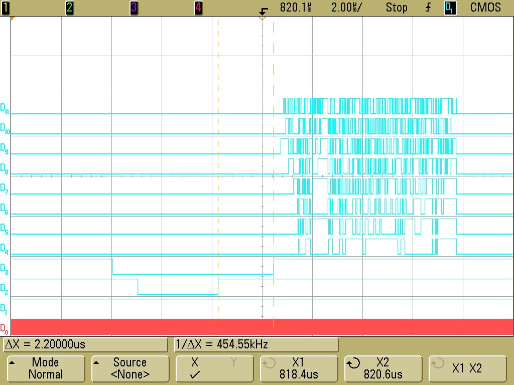

We are also able to capture the video timing while the display was shifted
The following is information describing the two captures:
Here are two bitmaps that capture the video timing signal. The video timings never changed which means it was stable; H front porch, h sync time, h back porch, and other timing was consistently the same between good and bad video offset.  On the shifted display capture the first column video data is not in the right spot in respect to horizontal position. It occurs sometime. The good video signal has the data start at same time as the DE transition from low to high. The display offset capture has data start occurring several pixel clocks after DE transition from low to high which it could be 4 clocks or 8 clocks or 12 clocks or etc. Once it occurs may stay offset consistently for few a minutes to several hours and then recover back to the correct position. You can see on the good video capture the data is present right on the DE rising transition which has the red cursor line while the bad one has data several clocks after the red cursor
 Signal detail on the bitmap waveform
  • D0 – Pixel clock
  • D1 – VSYNC
  • D2 – HYSNC
  • D3 – DE
  • D4-D11 – 8 bit red data
