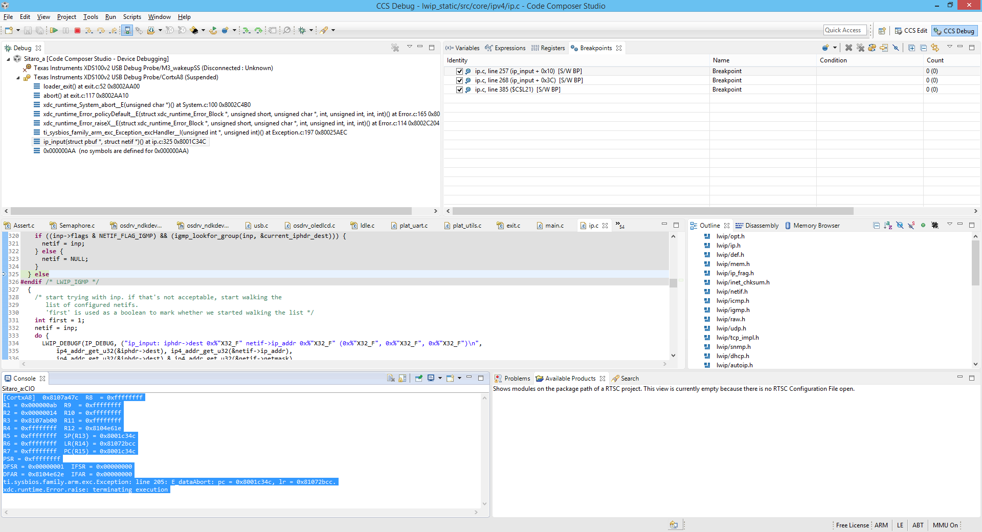

    But there is another issue: I got data abort error in function ip_input:
    [CortxA8]  0x8107a47c  R8  = 0xffffffff
    R1 = 0x000000ab  R9  = 0xffffffff
    R2 = 0x00000014  R10 = 0xffffffff
    R3 = 0x8107ab00  R11 = 0xffffffff
    R4 = 0xffffffff  R12 = 0x8104e61e
    R5 = 0xffffffff  SP(R13) = 0x8001dbcc
    R6 = 0xffffffff  LR(R14) = 0x81072bcc
    R7 = 0xffffffff  PC(R15) = 0x8001dbcc
    PSR = 0xffffffff
    DFSR = 0x00000001  IFSR = 0x00000000
    DFAR = 0x8104e62e  IFAR = 0x00000000
    ti.sysbios.family.arm.exc.Exception: line 205: E_dataAbort: pc = 0x8001dbcc, lr = 0x81072bcc.
    xdc.runtime.Error.raise: terminating execution
    The exception occurs on macro
    ip_addr_copy(current_iphdr_dest, iphdr->dest);
    What can be the reason of such behaviour and how can  I solve this issue?

    As fas as I unterstand the reason of error is data misalignment  (because of DFSR = 0x00000001), but I enabled generation unalignment loads and stores --unaligned_access=on in  project and lwip library/

    I tried with recomended settings:SYSBIOS 6.41.04.54 and XDC 3.30.06.67
    Result is the same.
    R5 = 0xffffffff  SP(R13) = 0x8001c34c
    R7 = 0xffffffff  PC(R15) = 0x8001c34c
    PSR = 0xffffffff
    ti.sysbios.family.arm.exc.Exception: line 205: E_dataAbort: pc = 0x8001c34c, lr = 0x81072bcc.

  • Hi
    I think the main problem is in unaligned access to memory - compiler doesn't generate it for strucrures ip_addr_t and ip_addr_packed.
    Are there any way to force compiler geterate unaligned access inctructions?
