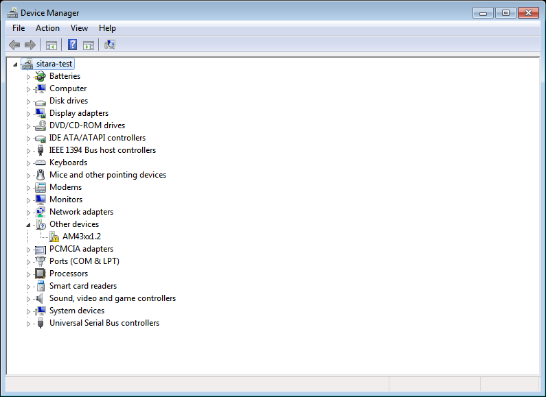

Use device manager while the board is plugged in to the computer by USB:

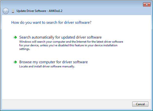

Right click on AM43xx and choose Install Device Driver.

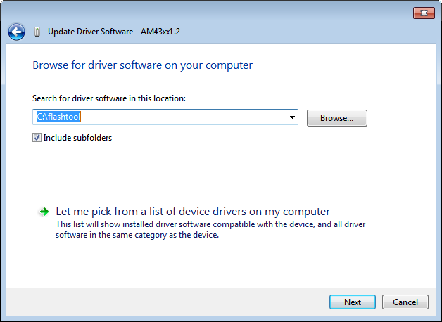

Browse your computer for the driver:
Click "pick from list":

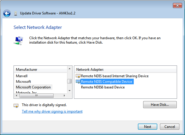

Then choose Network Adapter:
Then Microsoft and RNDIS:

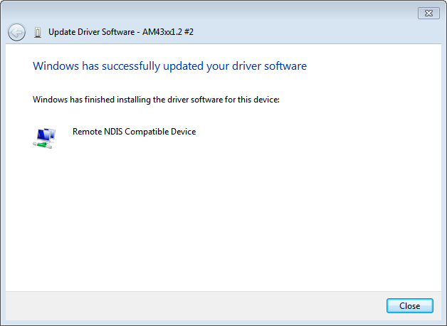

Windows will install the driver and tell you it's all done:

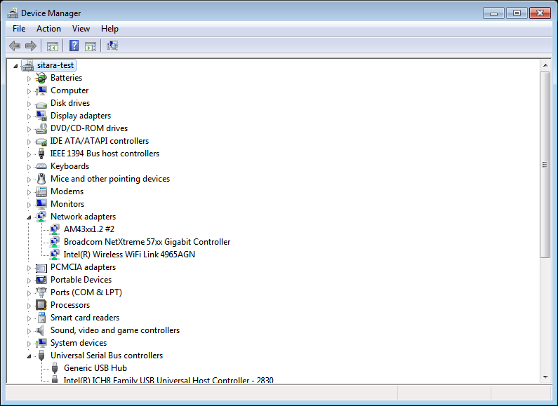

And Device Manager will be satisfied:
Finally, you will need to go through this process twice so that both the ROM Bootloader and U-Boot have a connection. Also, you will need to configure the new ethernet interface appropriately per the Uniflash documentation.
