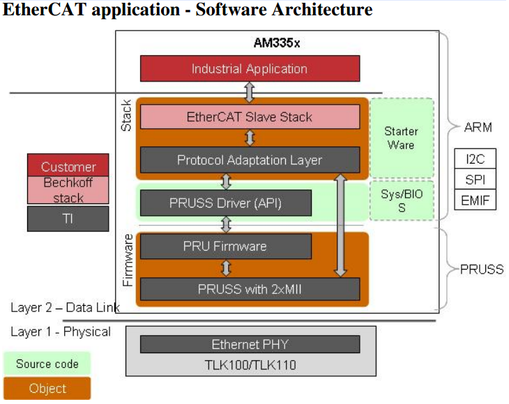

    I have seen a figure in <<EtherCAT Firmware API Guide.pdf>>, if I can move
    • EtherCAT Slave Stack Lib;
    • PRUSS Driver(API);
    • ESC related code in Sys/Bios and Starterware;
    • PRU Firmware;
    to an ordinary Linux System?
  • I had exact the same question. An answer would be appreciated.
  • Yes, you can port the driver and adaptation layers to Linux. That is exactly what the 3Ps are doing. However you need to consider different driver models and real-time behaviour in an HLOS. RT-Linux is recommended therefor. DC mode may be less trivial...
    The ETG stack is simple and may run in a single user task or app.
    PRU firmware won't change and it is implementing the majority of EtherCAT protocol anyway.
