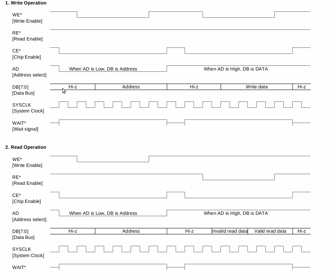

    i have rechecked my timings and the look right. for your reference i am attaching the timing diagram i am trying to achieve.
    any suggestions are welcome
    -Parker

  • I do not know which address line you are using for the "AD" signal.
    Assuming that you are using A2 as "AD" signal:
    *p32++ = address;
    *p32-- = value;
    If that is not working, I suggest you wrote a kernel driver to access the hardware. This is what everyone does, and it works.
    It may be that the memory you are mapping with mmap() is cachable. This will not work.
  • HI wolfgand
    I dont have any address pins i just use [ad0-ad7] to communicate with the asic. the ad0-ad7 pins act as both address and data bus.the AD signal is address latch enable (ALE_ADV)For the kernel driver i do not see any gpmc.c i n my project folder in ccs project includes.
    -Parker
  • If AD == address latch enable, you have a data/address multiplexed bus. So you have to set
    GPMC_CONFIG1_i[11-10] DEVICETYPE field = 00
    GPMC_CONFIG1_i[9-8] MUXADDDATA bit = 10b
    And the access is done via:
    p32[address] = value;
    or
    value = p32[address];
    Regarding kernel drivers: simply wrote your own. It's easy. There is a good book "linux device drivers" available online.
