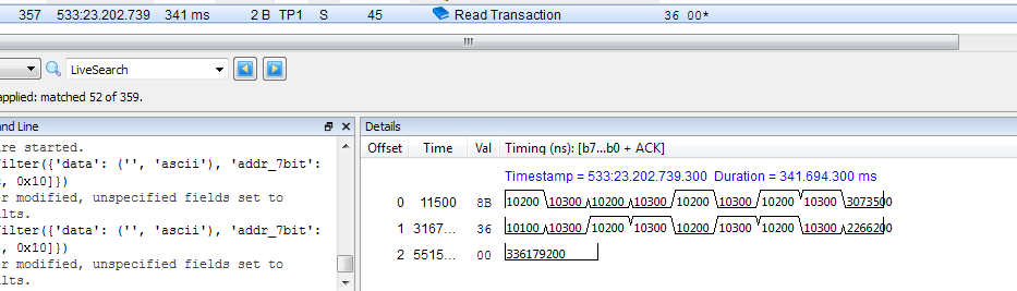

 I attach a screenshot showing the timings for the failed Slave TX and a log.

Screenshot:
rmi2c:[1642] Reg_GetBusActive mode=SLAVE
rmi2c:[194]:i2c_wait_bus_not_busy: entry (CON 0x8000 STATRAW 0x0)
rmi2c:[227] i2c_wait_bus_not_busy: (CTRREG 0x8000 STSREG 0x0)
rmi2c:[250] i2c_wait_bus_not_busy: return 0 (CTRREG 0x8000 STSREG 0x0)
rmi2c:Reg_GetBusActive: <SLAVE>  bus is free
rmi2c:[926]  SlaveIsThread: Bus is free, enabling i2c module. own addr=0x45
rmi2c:[596] omap_wait_status: mode=<SLAVE> entry: CON=0x8000 IE set= 0x29e STAT_RAW= 0x0
rmi2c:[632]  omap_wait_status: <SLAVE> AM335x_I2C_AAS slave state=10 STAT=0x1600 RAW=0x1600
rmi2c:[180] handleSlave:entry: STATRAW=0x1600
rmi2c:[307] handleSlave: state =  I2C_SLAVE_IDLE: TX started (BB|XUDF) but XRDY not on yet. setting mode I2C_SLAVE_TX
rmi2c:[1626] Reg_InterruptsClear. AM335x_I2C_IRQSTAT_RAW= 0x1610
rmi2c:[1627] Reg_InterruptsClear. Writing to AM335x_I2C_STAT 0x0
rmi2c:[638]  omap_wait_status: <SLAVE> done handleSlave
rmi2c:[671]  omap_wait_status: <SLAVE> done
rmi2c:  [958] SlaveIsThread: gotIntr[I2C_INDEX_SLAVE]==1 - released from omap_wait_status()
rmi2c:[963] I2C Slave MaxIntr:1
rmi2c:  [1002] SlaveIsThread: end while: Slave TX STAT=0x1610 RAW=0x1610
rmi2c:[596] omap_wait_status: mode=<SLAVE> entry: CON=0x8000 IE set= 0x29e STAT_RAW= 0x1610
rmi2c:[632]  omap_wait_status: <SLAVE> AM335x_I2C_AAS slave state=12 STAT=0x1610 RAW=0x1610
rmi2c:[180] handleSlave:entry: STATRAW=0x1610
rmi2c:[388] handleSlave: I2C_SLAVE_TX
rmi2c:[410] handleSlave: I2C_SLAVE_TX slave TX : XRDY/XUDF
rmi2c:[433] handleSlave: state = I2C_SLAVE_TX: SlaveTxSentBytes=1 data=0x36(6)  <<<<<<<<<<<<<<<<<<<<<<<<< {PIL} 1st byte ok
rmi2c:[1627] Reg_InterruptsClear. Writing to AM335x_I2C_STAT 0x10   <<<<<<<<<<<<<<<<<<<<<<<<<<<<<<< clear XRDY
rmi2c:  [1002] SlaveIsThread: end while: Slave TX STAT=0x1600 RAW=0x1600
rmi2c:[596] omap_wait_status: mode=<SLAVE> entry: CON=0x8000 IE set= 0x29e STAT_RAW= 0x1600
rmi2c:[632]  omap_wait_status: <SLAVE> AM335x_I2C_AAS slave state=12 STAT=0x1600 RAW=0x1600
rmi2c:[433] handleSlave: state = I2C_SLAVE_TX: SlaveTxSentBytes=2 data=0x37(7) <<<<<<<<<<<<<<<<<<<<<<<<<<<<< {PIL} 2nd byte ok
rmi2c:[1626] Reg_InterruptsClear. AM335x_I2C_IRQSTAT_RAW= 0x1200
rmi2c:[1627] Reg_InterruptsClear. Writing to AM335x_I2C_STAT 0x0   <<<<<<<<<<< not clearing anything
rmi2c:  [1002] SlaveIsThread: end while: Slave TX STAT=0x1200 RAW=0x1200
rmi2c:[596] omap_wait_status: mode=<SLAVE> entry: CON=0x8000 IE set= 0x29e STAT_RAW= 0x1200   <<<<<<<<<<<<< but now, only BB and AAS set
rmi2c:[632]  omap_wait_status: <SLAVE> AM335x_I2C_AAS slave state=12 STAT=0x1200 RAW=0x1200
rmi2c:[180] handleSlave:entry: STATRAW=0x1200
rmi2c:[447] handleSlave: SLAVE TX ??? que? statreg=0x1200          <<<<<<<<<<<<<<<<<<<<<<<<<<<<<< nothing to handle since XDRY / XUDF both 0

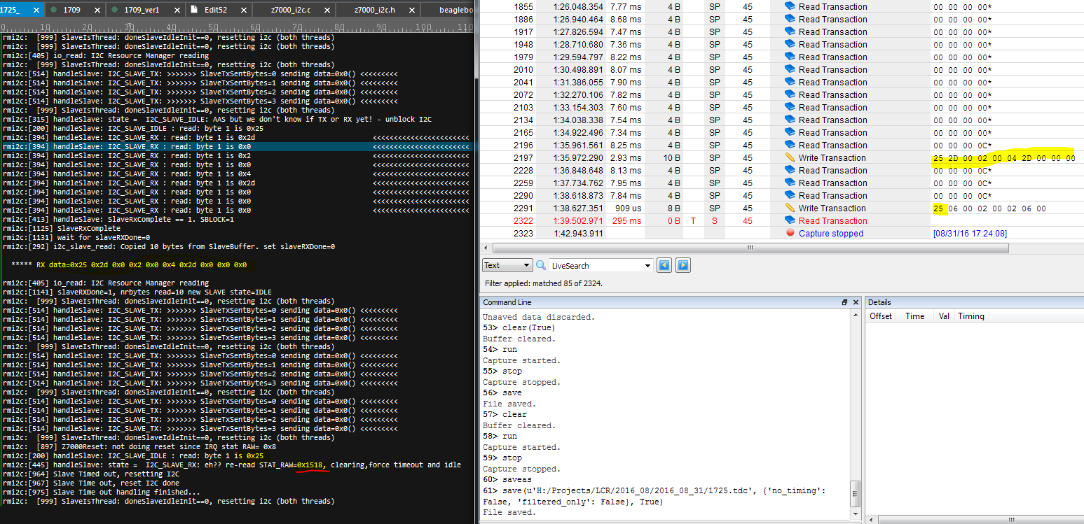

  • I have now got the interrupt based driver into better shape, where it's starting to talk to the gateway. I have applied most of the guidelines from Matthijs in the thread e2e.ti.com/.../1961190, who deserves a big thank you for this most useful information! A fraction of the info there I also found myself by gut feel and brute force experimentation, so it’s good that the small portion I found out myself also tallies.
    Shown in the screenshot are the AM335x does a slave TX (000C) followed by a write to the slave, where the AM335x does a slave RX, and our application has received successfully (0x25 2d 00 02 etc...).
    However, the next time the master writes to the slave, on the 2nd byte, we get 0x1518 in STATRAW, which is AAS|XUDF | BF|XRDY | RRDY
    XUDF and XRDY are unexpected here. What I will try tomorrow, is to simply ignore those and see if it’s possible for the RX to proceed regardless, since my driver’s state machine knows we are in RX not TX here.
    I will also look at how to trigger the scope on this occurrence so we can zoom in on the I2C line waveforms, this will hopefully be easier than in the polling driver.
  • Apols, 0x1518 is BB | XUDF | BF|XRDY | RRDY
    Note BB and BF asserted at the same time! In my state machine I am generally ignoring BF, as I find it generally does whatever it pleases, and I cannot rely on it. I am not sure why that is and if there is a way it could behave as intended.
    For slave TX, I am relying on NACK from master, and slave RX look for ARDY in order to know we have finished.

           - Gateway does a Master READ to device 0 and device 0 reply with a SLAVE WRITE.  (ok - AM335x slave TX)
           - Gateway does a Master WRITE to device 0. (ok - AM335x slave RX)
           - Then device 0 becomes MASTER too.  <-- failed (AM335x master TX) at this point in my "most good" code
    So signs of life, but reliability in this simple exchange was not 100% - and that's before other masters appeared on the bus. So lots more work, and of course don't treat the pseudocode as a reference (I can't give a warranty on something that doesn't work ;-)
    Perhaps TI may be able to provide further guidelines based on the info I have shared with them whilst debugging this.
