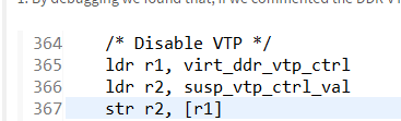

Some questions now I have might need your help to confirm
1. For the main OSC: they used the 25MHz. Is there any report related to this wake up issue with such 25 frequency?
2. For the DDR design with VTT: they don't use the GPIO to control the output of VTT. So according to the previous talk, the assembly codes of below is commented, in order to get it work well in suspend mode. Will this affect the issue?
In addition, we found that, if the wake up time is much faster (like using rtcwake -d /dev/rtc0 -m mem -s 1), it is much easier to reproduce this issue.
