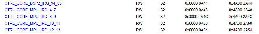

  • Pavel Botev said:
    Can you be more specific about what error you have found in this CSL_xbarMpuIrqConfigure() function?
    This is the original function:
    void CSL_xbarMpuIrqConfigure(Uint32 irqNumIdx, CSL_XbarIrq xbarIrq)
        CSL_control_intr_dmaRegs *ctrlCoreIntrDmaReg =
            (CSL_control_intr_dmaRegs *) CSL_MPU_IRQ_DMARQ_CROSSBAR_REGISTERS_REGS;
        CSL_control_coreRegs *ctrlCoreReg =
            (CSL_control_coreRegs *) CSL_MPU_CTRL_MODULE_CORE_CORE_REGISTERS_REGS;
        Uint32 regIdx = (irqNumIdx - 1U) / 2U;
        Uint32 regLsb = (((irqNumIdx - 1U) % 2U) * 16U);
        Uint32 regMsb = regLsb + 16U;
        if((CSL_XBAR_IRQ_MIN < xbarIrq) && (CSL_XBAR_IRQ_MAX > xbarIrq))
            if ((0U < irqNumIdx) && (CSL_MPU_IRQ_XBAR_COUNT >= irqNumIdx))
                ctrlCoreReg->MMR_LOCK_2 = 0xF757FDC0U;
                CSL_FINSR(ctrlCoreIntrDmaReg->MPU_IRQ[regIdx],
                    regMsb, regLsb, xbarIrq);
                ctrlCoreReg->MMR_LOCK_2 = 0xFDF45530U;
    Mapping per this original erroneous function:
    MPU_IRQ[0] - 1 and 2
    MPU_IRQ[1] - 3 and 4
    MPU_IRQ[2] - 5 and 6
    and etc..
    Mapping per datasheet:
    MPU_IRQ[0] - 4 and 7
    MPU_IRQ[1] - 8 and 9
    MPU_IRQ[2] - 10 and 11
    and etc..

    I suspect that datasheet is wrong again and MPU_IRQ registers skip some N/A IRQs (like they do it with 5 and 6), because starting from 133, IRQ pending flags start to go off their expected positions. Can you please verify it?
  • Oops, I found it. Datasheet is correct, I am blind. 131 and 132 are skipped, but 139 and 140 are not. This is the updated version of CSL_xbarMpuIrqConfigure(). Now all "normal" IRQs do fire, except for 133, which might be OK, as long as it is not entirely normal.
            "Crossbarable" MPU IRQs are 4..159, except 5, 6, 131, 132, 139, 140
        Uint32 regIdx;
        Uint32 regLsb;
        if ((irqNumIdx == 4) || (irqNumIdx == 7))
            regIdx = 0;
            regLsb = (irqNumIdx == 4) ? 0 : 16;
        else if ((8 <= irqNumIdx) && (irqNumIdx <= 130))
            regIdx = 1 + (irqNumIdx - 8) / 2;
            regLsb = (irqNumIdx & 1) ? 16 : 0;
        else if ((133 <= irqNumIdx) && (irqNumIdx <= 159))
            if ((irqNumIdx == 139) || (irqNumIdx == 140))
                return;
            regIdx = 62 + (irqNumIdx - 132) / 2;
        else
            return;
        if ((CSL_XBAR_IRQ_MIN <= xbarIrq) && (CSL_XBAR_IRQ_MAX > xbarIrq))
