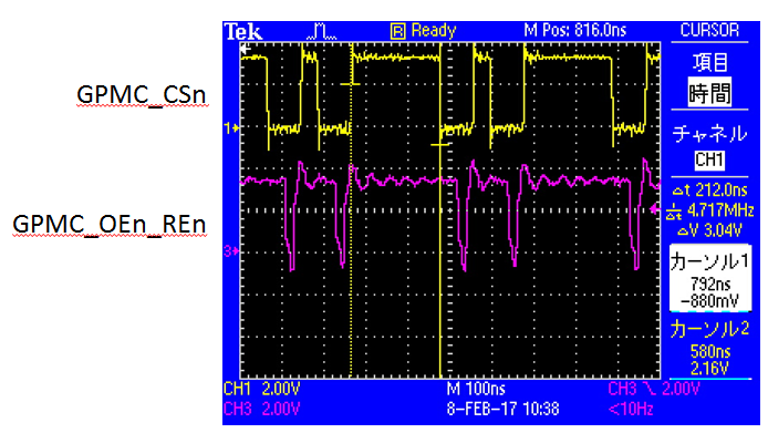

I and my customer would like to improve GPMC read access time.
The primary GPMC configuration is like follows..

Wave form:
CS on and off, OE on and off of waveform looks OK, but cycle2cycle is not good.
CYCLE2CYCLEDELAY of program is 4 but cycle2cycle of waveform is 212 ns.
So my target is shorten the cycle2cycle time.

"the problem with the GPMC is the internal bus arbitration time. If you use single byte reads, you won't get any further."
Now, my question is
1. the internal bus arbitration can disturb the GPMC access ?
2. Using EDMA can shorten the cycle2cycle ?
3. Asynchronous Multiple(Page Mode) Read can improve the GPMC access time ?
4. Any ideas, suggestions are welcome.
