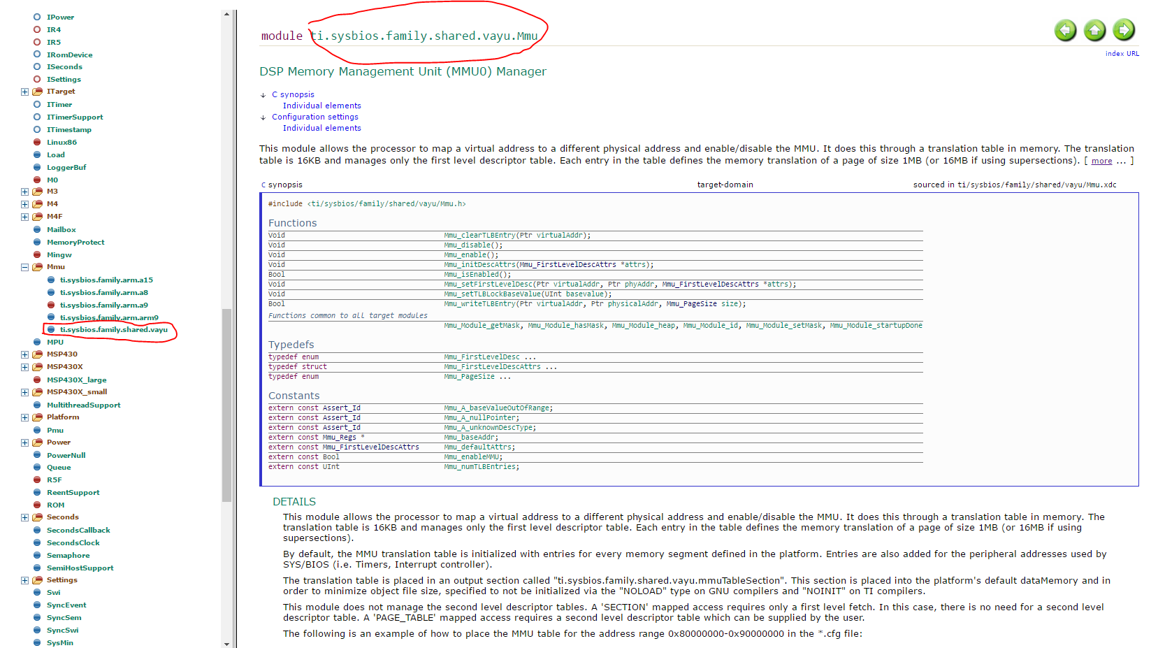

    We use Ti bootloader twiked for our hardware and initialized the GPMC to communicate with the FPGA . When we run the bootloader we can see the FPGA registers and modified them as well. ==========> Please clarify the TI processor SDK RTOS release version for this problem. And which source code files in TI bootloader you used/modified to configure GPMC? What is the boot mode (MMCSD, QSPI)? Do you use TI AM572x EVM or customer board? How do you read and confirmed that the GPMC registers are untouched? From A15 memory window? C66x window?
    I have some suspicion that in bootloader that you looked through A15 and MMU is disabled.
    Then let say you connected the JTAG to AM57x, do you remove all the GEL files to avoid the same initilzation work already done by bootloader?
    What core you connected to? A15 or C66x? Where your application intends to run? All are unclear to me.
    Is your application bare metal? Or your application is SYSBIOS? Do your application enable MMU? UART_BasicExample_idkAM572x_armExampleProject enables MMU in the SYSBIOS configuration, you can't read GPMC registers directly in A15 memory window anymore if you runs this program to main(). You have to setup MMU for access. Check
    e2e.ti.com/.../1989911 if help.
    Also, you can look through DSP core to make sure if GMPC is really corrupted from _c_int00 to main(), or you just looked it from a wrong way because of MMU setting. Also, GPMC_REVISION register is read only, it can't be corrupted.
    Regards, Eric
  • Hi Eric,
    Here is my answers to your questions.

    The boot mode QSPI.
    Milos:
    I tested this on customer and Ti Am572x idk and the same result.
    Milos:
    Yes we remove all the GEL files since we do all initialization in the bootloader.
    Milos:
    We are connected to A15 core 0 and our application intends to run from there.
    Milos:
    My Application is SYSBIOS and enables the MMU.
    Milos:
    Can you please send to me correct link to check this.
    Milos:
    I will check this.
    Milos
    I added the part for the MMU init from the post above and now I can see the GPMC registers correctly when I stop in the main but I still could not read from the FPGA and write to the FPGA memory space 0x01000000 and 0x02000000.
    What else I need to do to make this to work.
    Milos
    Good to know now you can see the GPMC configuration registers correctly from A15. Now the real problem is that GPMC doesn't work with FPGA.
    Do you set up the MMU attribute for the GPMC data region? For all the GPMC registers you programed (showed in yesterday post), what code you referred to?
    Regards, Eric
    As I already explain to you I could read/Write to the FPGA when I stop in the _c_init00 means the bootloader initialized the GPMC correctly and I could see the GPMC registers as well.
    After adding your code in the .cfg going from _c_init00 to the main I still could see the GPMC registers but I coulld not read/write to the FPGA anymore.
    Could you please send to me what I need to add to the .cfg file to fix this.

  • Milos, Eric,
    I have a suspicion that we are using incorrect MMU module in the SYSBIOS configuration. In going over SYSBIOS documentation I noticed there are two different MMU modules: ti.sysbios.family.arm.a15.Mmu and also ti.sysbios.family.shared.vayu.Mmu. Is it possible that we should be using the "Vayu" one? Can you give it a try to see if it helps?
    Michael

  • Hi Milos,
    You are programming the correct MMU module (ti.sysbios.family.arm.a15.Mmu). There might be something broken with the configuration. Can you share your application's *.cfg file ?
