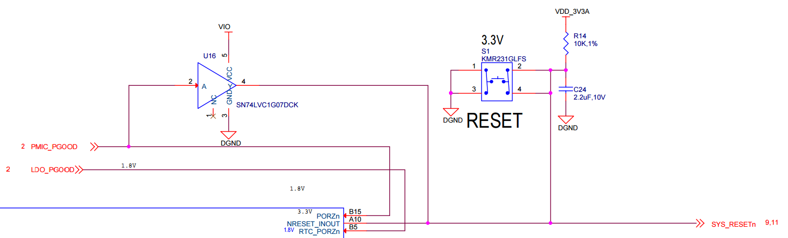

Part Number: AM3352
Hi, Everyone
I have a question about nRESETIN_OUT:A10 of AM335x.
Is there any possibility that the reset will not be effective
when nRESETIN_OUT is set to Low?
I think Effect of reset never goes away
when nRESETIN_OUT is set to Low.
Because this warm reset regardless of the signal direction.
This understanding is correct ?
If there is a possibility that a reset will not be issued, please tell me.
Best Regards
Hiroyasu
Hi, Biser
Thank you for your reply.
O.K. We will try it.
and Do you have any answer for this:
My question is whether or not AM335x has a specification that is not r
eset on nRESETIN_OUT.
Best Regards
Hiroyasu
