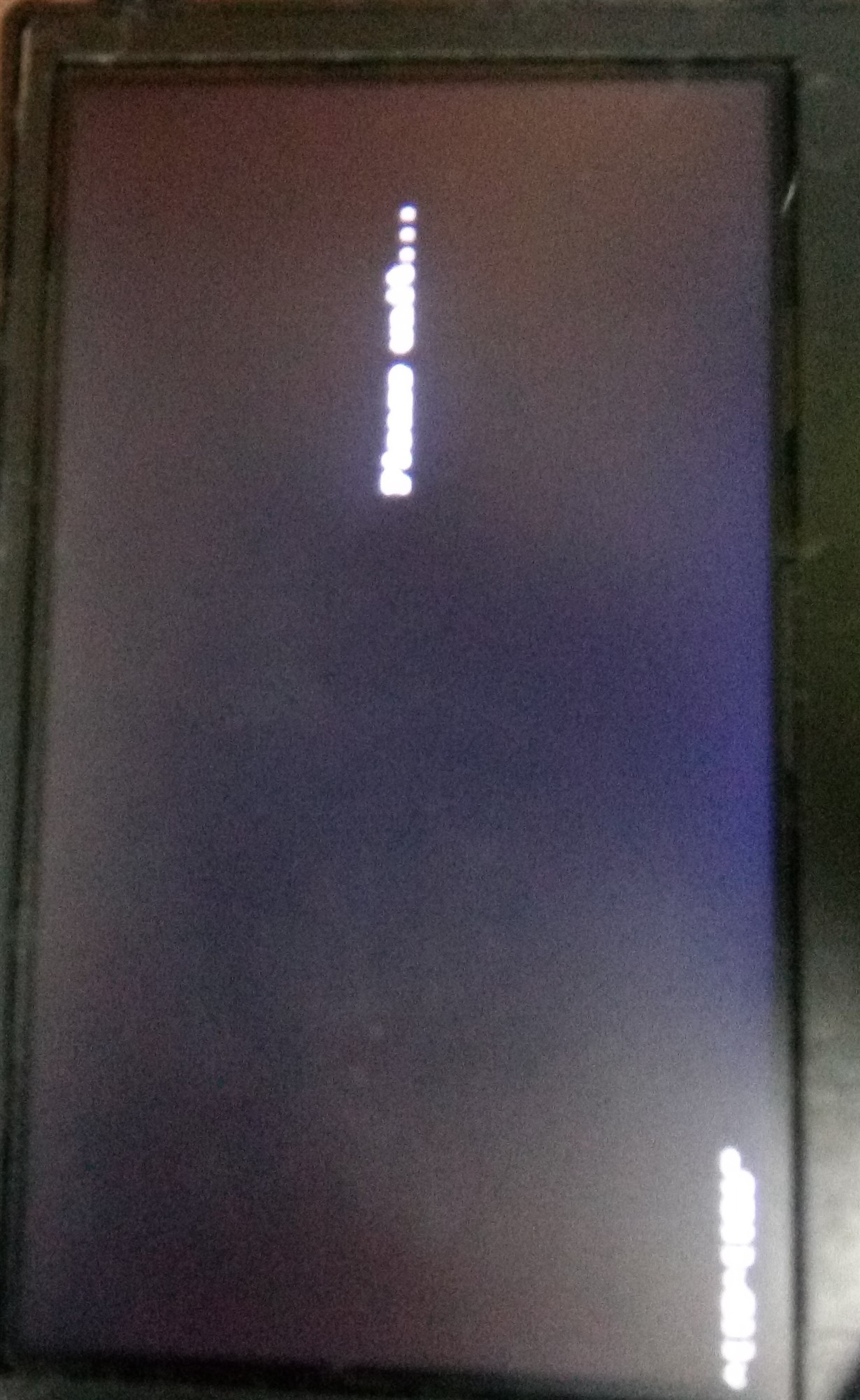

I am using custom AM335x board with LCD.
When I do cat "Image.name" > /dev/fb0, I can see the image properly on the LCD.
But  when I start Matrix GUI application, it is not running on the LCD screen, Screen is only showing "please wait..."
/------------------- Start Matrix GUI application ------------------------/
/etc/init.d/matrix-gui-2.0 start
/home/root
Removing stale PID file /var/run/matrix-gui-2.0.pid.
Starting Matrix GUI application.

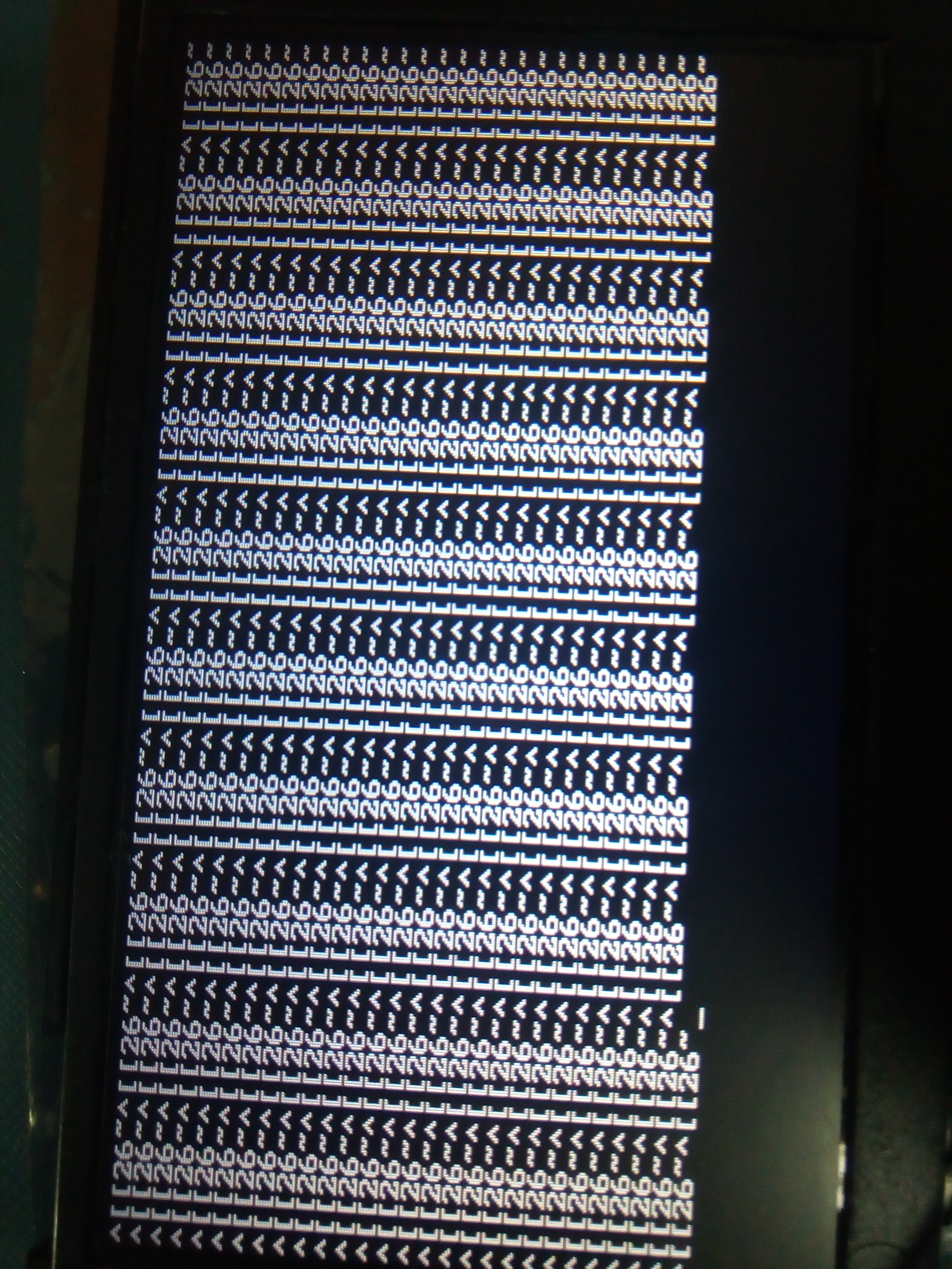

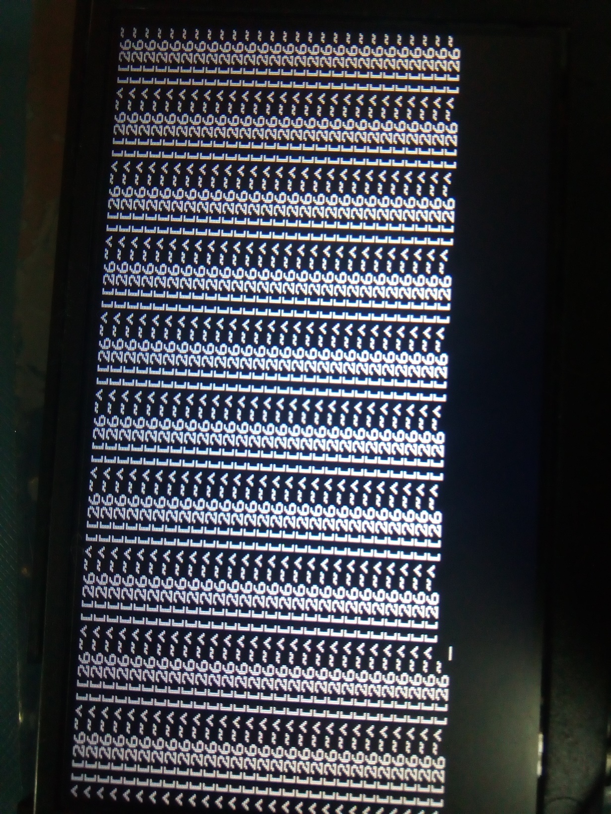

    Thank you for your response.
      Here I am attaching two photos of LCD
    1). while booting -- LCD activity while booting
    2). After booting -- LCD activity after booting
    In the boot log I can see the weston and matrix services started. But when I fire ps -aux, I can't see any process running .
    For Weston  process I can't see in ps -aux, so I stop the service using "/etc/init.d/weston  stop"

    Add to last post It seems that
    First we need to start weston that matrix GUI.
    When weston will start white screen will be come and than matrix GUI will start.
    But in may case weston is not going to start.
    Is it the correct process to start Matrix GUI?
    If yes than in my case it isn't happening.
    Please do the needful.
    -- Ronak

    I have the same issue, i'm using 10.4" LVDS display. In my case lcd is up we able to see penguin logo while booting & then comes to login prompt. But no matrix gui application, i'm using latest SDK 04.00.00.04 with 4.9.28 kernel.
    Even i tried to display some image on lcd but didn't came. Like i tried by downloading some image as 800x600 resolution jpeg image and tested like cat "image.jpeg" >> /dev/fb0
    Can you please tell me, how can i resolve this issue.
    Please find the kernel log & dts file.KernelLog_Config_Dts.tar.gz
