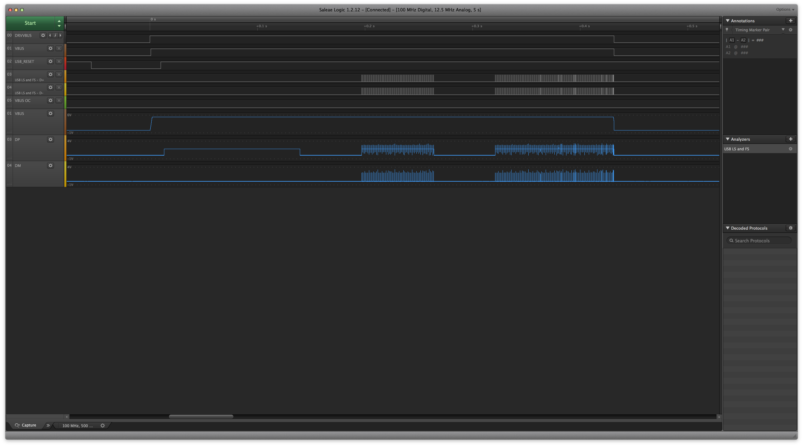

  • Please see below a logic analyser trace stowing the state of the various signals associated with a failed connection attempt and subsequent VBUS drop-out scenario described above:
    Garry
  • Hi Garry,
    It is not a hard and fast rule to "Ensure VBUS is not present prior to us asserting USBn_DRVVBUS (VBUS power switch control)." Can you give a try by removing this logic ? Looks like there is delay in getting the VBUS voltage above valid VBUS level within expected time and hence VBUS error.
    Could you elaborate on "expected time"? VBUS reaches 4.4V in approx 1.9ms and full supply level (5.2V) in approx 2.4ms - I was led to believe that the window for a valid VBUS on Sitara was significantly longer than that.
    Stu

  • Dwarakesh R said:
    Hi Garry,
    This is the default for device operation. The OS must be configured to skip this rule.
    The scope plot shows attempted enumeration. This wouldn't occur if the VBUS test had failed.

  • Pretty much. Some instrumentation in the code suggests that u-boot builds a list of the three ports on the hub to be probed, but VBUS has been removed before it gets as far as probing the hub ports.
    More interestingly, we have made some progress, but would like to know why it makes a difference. So first a little more background:
    Because the DRVVBUS/VBUS connection is a closed loop (i.e. it is purely for the benefit of the processor, and isn't actually powering the integrated hub device, which is permanently powered) our hardware guys simulated the VBUS ramp up using an RC network on the output of the 5V switch driven by DRBVBUS. This replicates the ramp up seen when VBUS has a large bypass capacitor (for in-rush current protection I understand - as per USB 2.0 spec which states minimum of 120uF).
    If I add a large bypass cap (happen to have 220uF) between VBUS and GND, it appears to allow u-boot to function correctly and fully enumerate all of the devices (well most of the time, occasionally it fails to spot the mass storage device, but it always finds the USB ethernet adapter - this may be the result of a known issue on the TUSB2036).
    So our questions are
    1. What is it about this cap which changes the behaviour (other than extending the VBUS ramp time from 2.5ms to 3.2ms to the full rail 5.2V)?
    2. Is this the actual solution?
    We don't see any glitching on VBUS without it, so seems unlikely it is a smoothing effect.
  • Stuart,
    1) The controller expects capacitance on VBUS as per the USB specification. For Host mode operation the minimum requirement is 120uF. This affects both HW and SW timing, which as you have pointed out earlier in this thread, appears to be suspect.
    2) Very possibly. Please add 120uF to USBn_VBUS and re-run your test. We are looking to see if this results in 100% enumeration of the hub itself.
