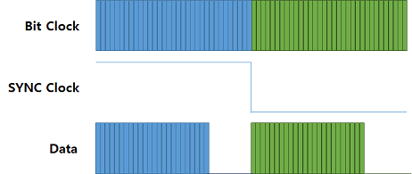

Hi.
I am trying to read MCASP using ALSA library.
I found read error message. "arecord: pcm_read:2032: read error: Input/output error"
please check my system.
- I2S format
AM3352 receive I2S data and clock from Bluetooth module.
I2S bit format is 32bit slot size, 24bit word and Left justified.
- Kernel device driver (4.4.32 version)
I am not sure the tdm_slot function is correct -> (snd_soc_dai_set_tdm_slot(cpu_dai, 0xFFFFFF, 0xFFFFFF, 24, 32);

- Error log
root@am335x-evm:~# arecord -f S24_LE -r44100 -c2 -D hw:0 -F0 --period-size=1024 -B0 --buffer-size=4096 test.wav
[ 1593.396642] [kdj6724] soc_pcm_open(459)
[ 1593.400984] [kdj6724] soc_pcm_open(472)
[ 1593.404870] [kdj6724] davinci_mcasp_startup(1329)
[ 1593.415125] [kdj6724] soc_pcm_open(474)
[ 1593.425865] [kdj6724] soc_pcm_open(483)
[ 1593.433381] [kdj6724] soc_pcm_open(485)
[ 1593.443950] [kdj6724] soc_pcm_open(515)
[ 1593.453006] [kdj6724] evm_startup(40)
[ 1593.456750] [kdj6724] soc_pcm_open(517)
[ 1593.468324] [kdj6724] soc_pcm_open(529)
[ 1593.472254] [kdj6724] snd_soc_dai_stream_valid(46)
[ 1593.489922] [kdj6724] soc_pcm_open(532)
[ 1593.494655] [kdj6724] snd_pcm_mmap(3510)Recording WAVE 'test.wav' : Signed 24 bit Little Endian, Rate 44100 Hz, [kdj6724] snd_pcm_lib_ioctl_fifo_size(1819)
Stereo
[ 1593.533111] [kdj6724] snd_pcm_lib_ioctl_fifo_size(1819)
[ 1593.545722] [kdj6724] snd_pcm_lib_ioctl_fifo_size(1819)
[ 1593.558987] [kdj6724] snd_pcm_lib_ioctl_fifo_size(1819)
[ 1593.564374] [kdj6724] snd_pcm_lib_ioctl_fifo_size(1819)
[ 1593.584878] [kdj6724] snd_pcm_lib_ioctl_fifo_size(1819)
[ 1593.595159] [kdj6724] snd_pcm_lib_ioctl_fifo_size(1819)
[ 1593.607747] [kdj6724] snd_pcm_lib_ioctl_fifo_size(1819)
[ 1593.613125] [kdj6724] pcm5102a_capture_hw_params(105) codec_dai:pcm5102a-hifi cup_dai:48038000.mcasp[kdj6724] snd_soc_dai_stream_valid(46)
[ 1593.643995] [kdj6724] davinci_mcasp_hw_params(1131) cpu_dai->name:48038000.mcasp
[ 1593.664293] [kdj6724] davinci_mcasp_set_dai_fmt(436) val:3
[ 1593.678043] [kdj6724] davinci_mcasp_hw_params(1156) mcasp->op_mode:0
[ 1593.684574] [kdj6724] mcasp_i2s_hw_param(933) stream:1 channels:2 total_slots:2
[ 1593.707050] [kdj6724] mcasp_i2s_hw_param(964) active_slots:2 active_serializers:1
[ 1593.714878] [kdj6724] mcasp_i2s_hw_param(980) 0x00000003
[ 1593.735435] [kdj6724] davinci_config_channel_size(792)
[ 1593.927522] [kdj6724] snd_pcm_capture_ioctl1(2919) cmd:-2146680495
[ 1593.933892] [kdj6724] cmd:1
[ 1593.936704] [kdj6724] davinci_mcasp_start(271) stream:1
[ 1594.057939] [kdj6724] TXTDM_REG     : 0x00000000
arecord: pcm_read:2032: read error: Input/output error[ 1604.208364] [kdj6724] cmd:0
[ 1604.215127] [kdj6724] mcasp_stop_rx(283)
[kdj6724] davinci_mcasp_shutdown(1419)
[ 1604.359540] [kdj6724] TXTDM_REG     : 0x00000000
[ 1604.364288] [kdj6724] evm_shutdown(54)
root@am335x-evm:~#

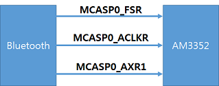

    And I found something that can not understand so I attach more detail
    this is connection between BT and AM3352. BT is operated as master, AM3352 is slave.
    AM3352 receive clock configuration is
    In this figure I think ASYNC value would be set. But "mcasp_i2s_hw_param() (davinci-mcasp.c)" function always make ASYNC value clear.
    I do not understand why. Is it ok to change mcasp_clr_bits to mcasp_set_bits.  (Line 48)

  • Part Number: AM3352
    Tool/software: Linux
    Hi.
     I am trying to record I2S data. I have record problem. The problem is record data has a lot of noise or no valid data.
    I have checked several point to fix it. I found something strange thing. Please check this.
    my block diagram is this.
    So I did MCASP clock configuration like this
    The problem is ASYNC bit configuration in MCASP0 side. I want to use separately RX clock and TX clock.
    So When I set ASYNC bit(Asynchronous), RSRCLR(GBLCTL) bit is never set. In fact in davinci-mcasp.c alaway clear ASYNC(Synchronous), I do not know why.
    I want to know, is there any problems with my  structure using different MCASP part RX and TX.
    thank you
