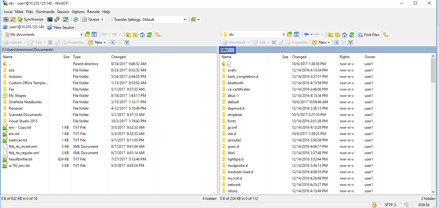

  • Hi Tsvetolin,
    I understand that dropbear is part of the Processor SDK, in development, we can ssh into box as with any other ssh solution. I also understand the dropbear process is started from systemd service when a connection comes over port 22 (note: ssh access will likely be disabled when our system goes into production).
    Our product requirement is that the sftp server must limit the access of the sftp client to the user's pre-configured home directory. In this assigned directory (and sub-directories)
    The sftp client can read/write files as well as as create create sub-directories...etc. Please see attached <inhome.png >  which user1 is limited to the /home/user1 directory (and subdirectories)
    This means that the sftp server MUST NOT allow the sftp client to access any other directory (in the depicted case - access to the '/etc/' directory)
