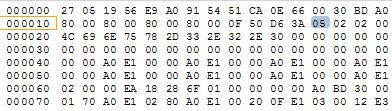

Looking at binary view of my zImage I can see that 29th byte is 0 when MLO expects it to be 5.
Reading about linux image headers it looks like uImage has the Header and zImage is compressed version and does not have it.
Is this correct?
Do I have to have uImage for MLO to recognise the Kernel.

    The check for linux kernel happens in MLO.
    The header of Zimage:
    The header of Uimage:
    Looking at these Uimage Has 5 at position 29 which is what MLO is expecting.
    I have a few questions:
    1. Why does MLO try to look for a kernel in the first place? I thought the sequence should be MLO -> U-boot -> kernel.
    2. Why does it try to look for a Linux OS marker which looks to be associated with Uimage.
