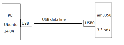

    The hardware circuit is shown in the following picture:
    A USB line is used to connect the P4 port to the PC, and the PC side uses the tool to open the /dev/ttyUSBxxx and communicate with the am3358.

  • andre feng said:
    How do you configure the USB in the device tree?
    This design uses USB0 in device mode, which is the same as that in the AM335x Starter Kit, or BeagleBone Black. You can refer to those device tree settings.

    On AM335x? Or Host PC?
    What usb gadget function do you want AM335x USB0 to be?
    When I load the usb-serial.ko driver on the AM3358 board USB0, can generate the /dev/ttyUSB0 device on the PC(ubuntu 14.04).
    Use /dev/ttyUSB0 interface from userspace to talk to the am3358 device.

  • If you want to use USB0 on AM335x to be a usb serial device, usb-serial.ko is not what you need, It will not generate /dev/ttyUSB* on the USB host. Please read kernel doc "Documentation/usb/usb-serial.txt" for more details about usb-serial.ko. You also need to read dmesg on the host PC and other logs to understand what generated /dev/ttyUSB0 on your PC.
    To use USB0 on AM335x as a usb serial device, you can use command 'modprobe g_serial.ko' on AM335x.
