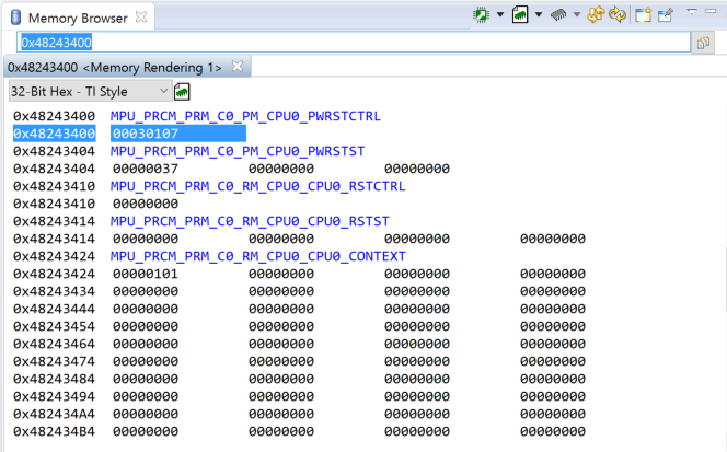

I have a problem with stability running TI AM5728 based custom board, similar to the Beaglebone X15. RTOS SW is running on one core MPU0 and sporadically (most often after several hours) freezes. When freezes it is impossible to connect to the MPU0 target by debugger, at the same time I can without any problems connect to the MPU1.
Debugger error: CortexA15_0: Trouble Halting Target CPU: (Error -1323 @ 0x1386AC) Device failed to enter debug/halt mode because pipeline is stalled. Power-cycle the board. If error persists, confirm configuration and/or try more reliable JTAG settings (e.g. lower TCLK). (Emulation package 6.0.504.1)
For test purposes, I have started the simple program on the MPU1, and when MPU0 freezes MPU1 continue normal operation. WFE and WFI flag for MPU0 is inactive, moreover, I have made the additional test with trying to put MPU1 to the WFI/FORCED_OFF state. However, I still can connect with debugger and wakeup it from the FORCED_OFF state, as described in the technical manual.

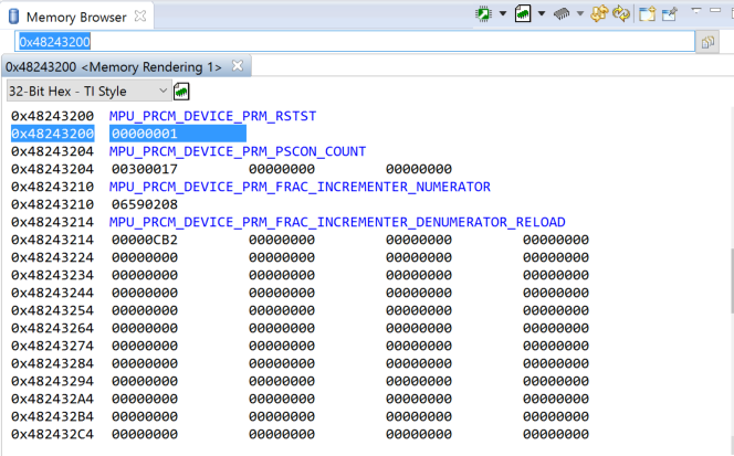

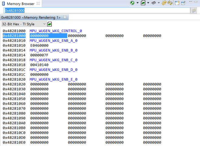

I have dumped the registers by connection to the CS_DAP_DebugSS and have not found anything special. Register dump attached:
What can be the potential cause of freezing problem just one core without a possibility of connection with debugger and second core running without problems?
