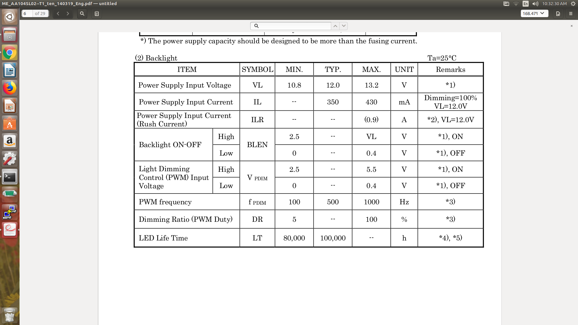

I'm working on our custom board, facing some issue with display back-light. Not sure why the backlight is coming, may be due to pwm driver/not.
Using the latest SDK "ti-processor-sdk-linux-am57xx-evm-04.02.00.09"
In dts file, i have done the below backlight configuration:
lcd_bl: backlight {
compatible = "pwm-backlight";
pwms = <&ehrpwm1 0 50000 0>;
brightness-levels = <0 1 2 3 4 5 6 7 8 9 10 11 12 13 14 15 16 17 18 19 20 21 22 23 24 25 26 27 28 29 30 31 32 33 34 35 36 37 38 39 40 41 42 43 44 45 46 47 48 49 50 51 52 53 54 55 56 57 58 59 60 61 62 63 64 65 66 67 68 69 70 71 72 73 74 75 76 77 78 79 80 81 82 83 84 85 86 87 88 89 90 91 92 93 94 95 96 97 98 99 100>;
default-brightness-level = <100>; /* index to the array above */
status = "okay";
&ehrpwm1 {
status = "okay";
pinctrl-names = "default";
pinctrl-0 = <&pwm_bl_pins>;
pwm_bl_pins: backlight_pins {
pinctrl-single,pins = <
0x0F4 (PIN_OUTPUT | MUX_MODE10) /* ehrpwm1a MUX_MODE10 */
I have put some debug messages in the pwm driver's still no clue, could you please go through the kerel config, and log and guide me if i'm missing something.
