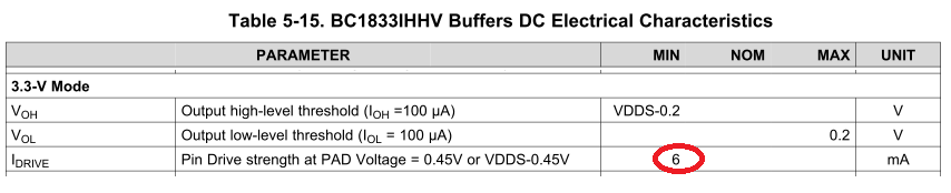

According to the Table 5-17. Dual Voltage LVCMOS DC Electrical Characteristics on AM5728 DM, it is written that "Idrive is minimum 6mA". And then, the description is written as the below.
   " Pin Drive strength at PAD Voltage =0.45V or VDDS-0.45V"
This description is the same as 1.8V mode and 3.3V mode. Does this mean Pin Drive strength is 6mA regardless  the voltage mode? If it is yes, what is maximum of drive strength?

  • Dear Ahmad-san,
    Thank you for your reply.
    According to the data manual of AM5728, the drive strength is the below.
    Does this mean the driver current is guaranteed 6mA at least?

  • Dear Ahmad-san,
    According to the data manual of AM5728,  the drive current is the below.
    Does this mean the drive current is guaranteed until 6mA at least?
    As to your advice, 6mA is typical value, I think. Customer need to know this pin's drive strength  for how many devices can be connected.

  • Hi Michi,
    The answer to your question is not simple because the drive strength of the pin output is not constant nor limited. You should use the ibis model for timing analysis. The section called "Timing Requirements and Switching Characteristics" in the datasheet has information on the test circuit used to measure and meet the timing specifications listed. Compare that with the capacitive loading of the devices you plan to connect to the AM57x.

    I need more information regarding "Idrive" parameter.
    My customer would like to know "Idrive" . What is "Idrive" used to describe what parameters?
    In AM5728 DM, Table 5-17, "Idrive" is written in the below.
    "Pin Drive strength at PAD Voltage = 0.45V or VDDS-0.45V"
    In datil, where is "PAD voltage" ?
    Idrvie =6 mA (min.) with PAD voltage =0.45V or VDDS-0.45V, does this current value shows for each pin? Or does it shows total current value for all pins using same VDDS?
    I think this pin is not needed to have the buffer if it is used as 6mA source. Is my understanding right?
