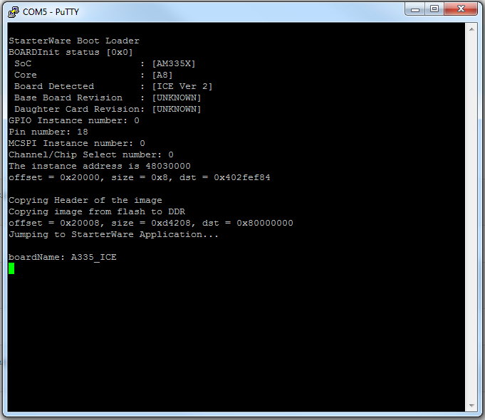

I was trying to flash PRP example to TMDSICE3359 EVM board. I prepared _ti.bin files, flashed bootloader (bootloader_boot_mcspi_a8host_release_ti.bin) and next my application. Next I reset system and here it is what I see on terminal:
but nothing more happened. Did I do something wrong?

  • Dawid,
    In addition to the information that you have provided here, can you also specify the Image Load Address that you used. when creating the app.
    the reason that I ask that is that it appears your application is being loaded to location 0x0 which I am not sure is correct. The application runs in DDR memory, so I would have expected the dst address to be 0x8XXX_XXXX format and not 0x0.

  • Rahul,
    thank you for your reply.
    You were right. My destination address was wrong. I didn't know correct address. I prepared files again using correct address: 0x80000000. In command window I typed:
    tiimage.exe 0x80000000 NONE prp_app_AM335x_arm.bin prp_app_AM335x_arm_ti.bin
    After long process of flashing here it is my log from terminal:
    And nothing more happens. It looks like I made another mistake. What should I check next?

  • Rahul,
    false alert. It hungs because I didn't close debugger session in CCS. After closing debugger session and restarting ICE v2 board it fired correctly. Here my log is:
