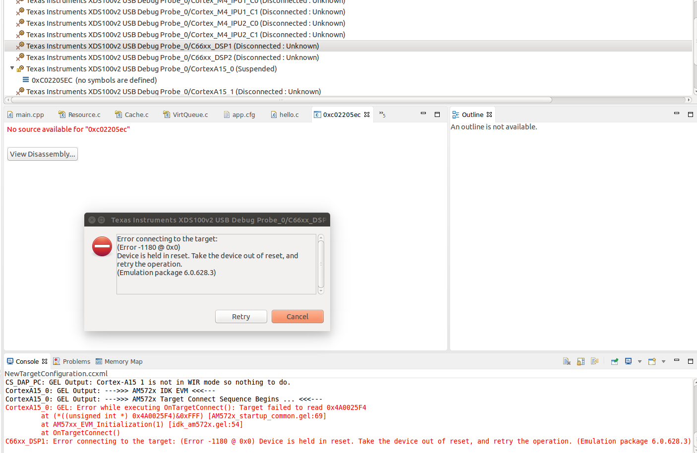

My board is idkAM5728. When running rt-linux on A15, DEBUG DSP RTOS program through CCS is not allowed.errors are reported as bellow:
when I remove the SD card from the board,these problem is solved,and I can do the DEBUG smoothly.

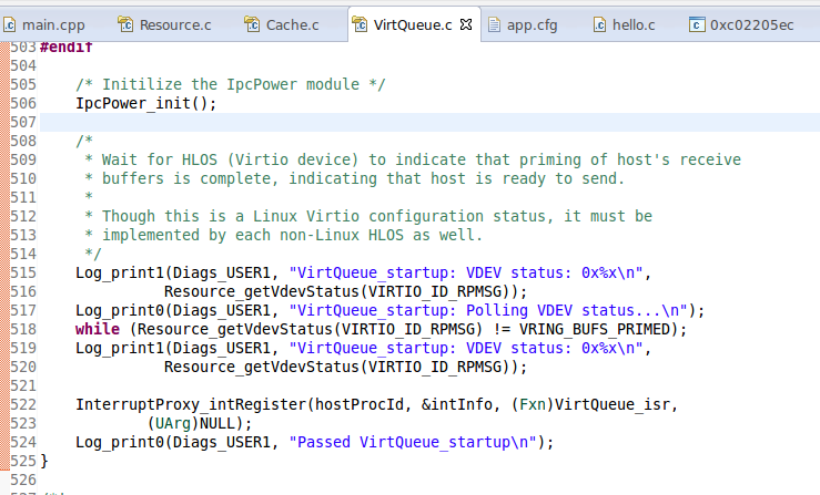

But now, I need some function which include ipc module.and my program will stop at VirtQuenec.c. show as follow:
It seems ipc module is powered by host OS. but I didn't run any OS on A15.

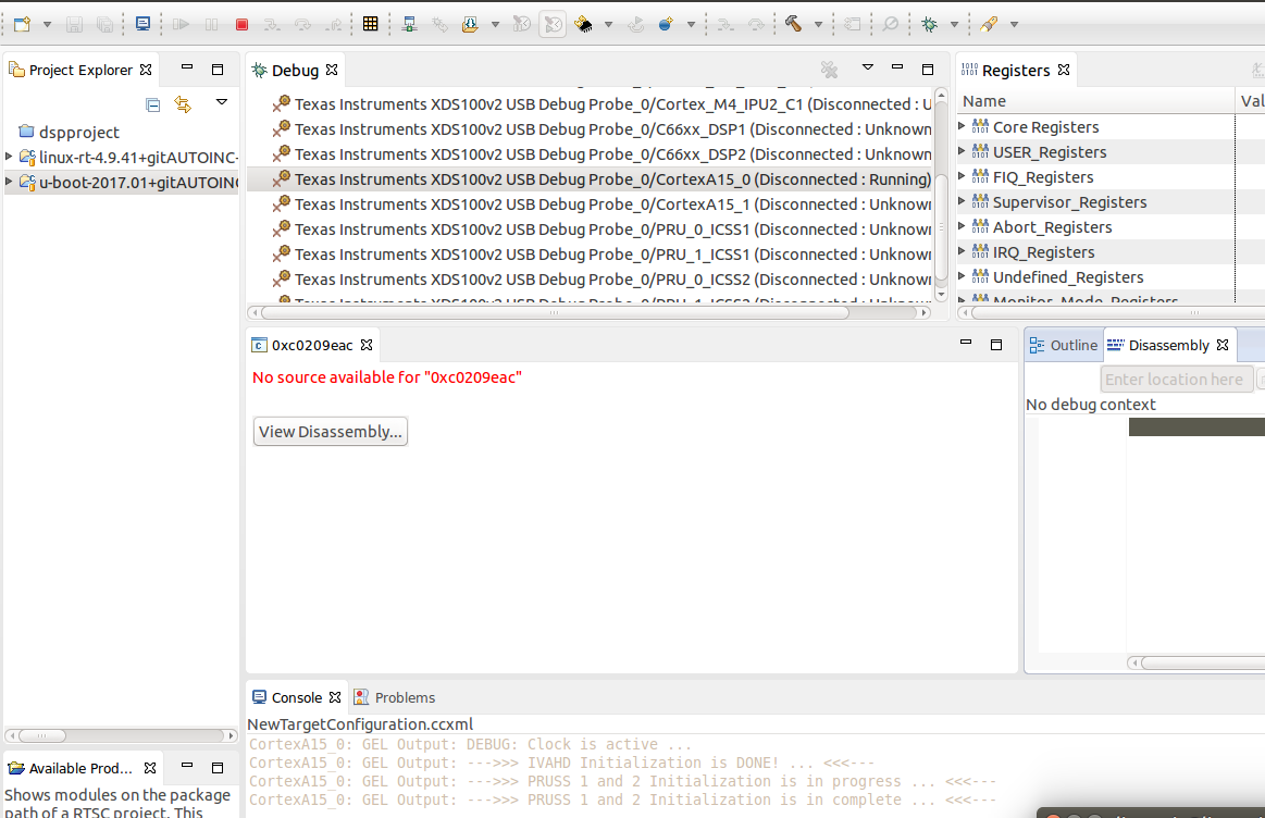

    I've followed your suggestion.but somethings are quite different with expectation.
    I've rebuilt U-Boot & linux kernel.and setup U-Boot & kernel project in CCSv7. That's OK (maybe nothing will cause a problem, I think).
    I met problems when I tried  Perform  Linux Kernel Debug section follow the wiki.

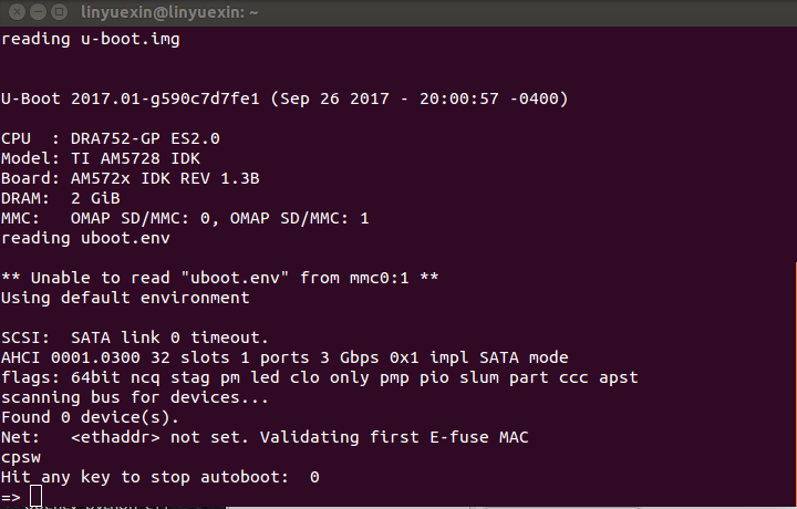

    In the Perform  Linux Kernel Debug section Step 2 to Step 6 is OK,  in Step 7,I got "=>" in the beginning while the wiki is "U-Boot#".
    And I don't see any yellow pause icon is available for suspending A15(Step 8).
    Also, I can't find a file similar to board-am335xevm.c (Step 10,I need a file looked like board-am57xxevm.c,I guess  ).

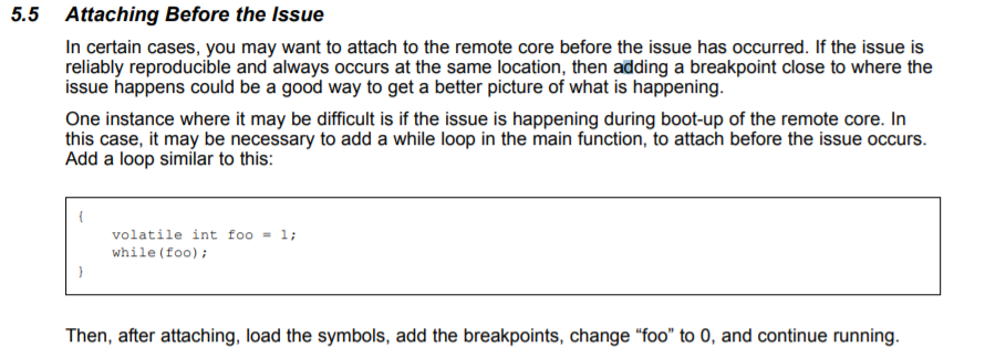

  • Yxxxx said:
    I need some help to debug my DSP program including IPC module,while A15 is running linux.
    The app note I linked goes into detail regarding how to do this. For example, one of the debugging techniques it describes is putting in a while loop to have the program wait there, and then connecting to the core, loading the symbols, and stepping through the code.
    This is just one technique described in the app note. There are other examples as well such as using traces, ROV, etc.

    My basic issue is described at the very beginning that A15 can't initialize the context.and DSP held in reset.
    I even can not begin to run the program.
    Yordan has provieded me some suggestion to solve it ,but I met some problem when implementing.
