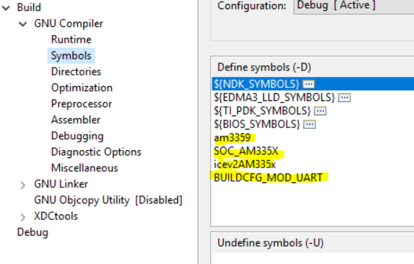

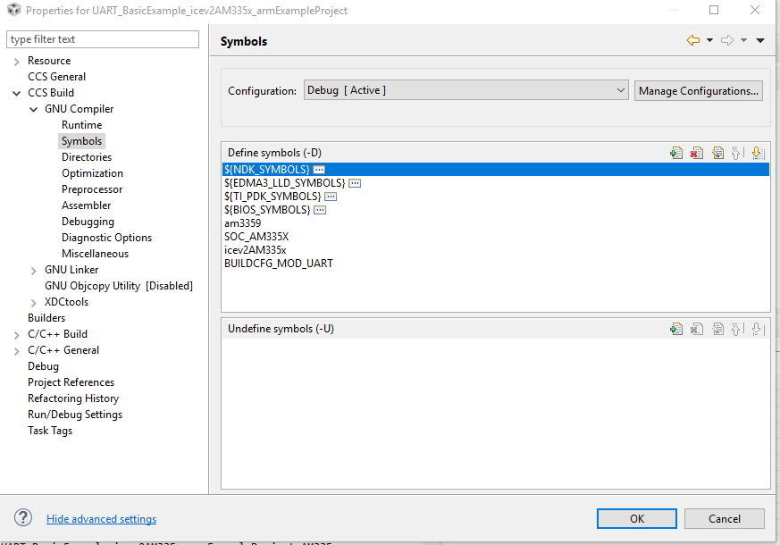

    After this opened command prompt in path C:\ti\pdk_am335x_1_0_7\packages
    • executed pdksetupenv.bat
    • gmake clean
    • gmake all
    • pdkProjectCreate.bat AM335x icev2AM335x little uart arm
    Finally opened CCS and imported UART_BasicExample_icev2AM335x_armExampleProject
    All expected symbols are present by default. Below is the image
    Rebuild it
    started to debug and run
    Please check am I missing any steps and are all the steps followed right.

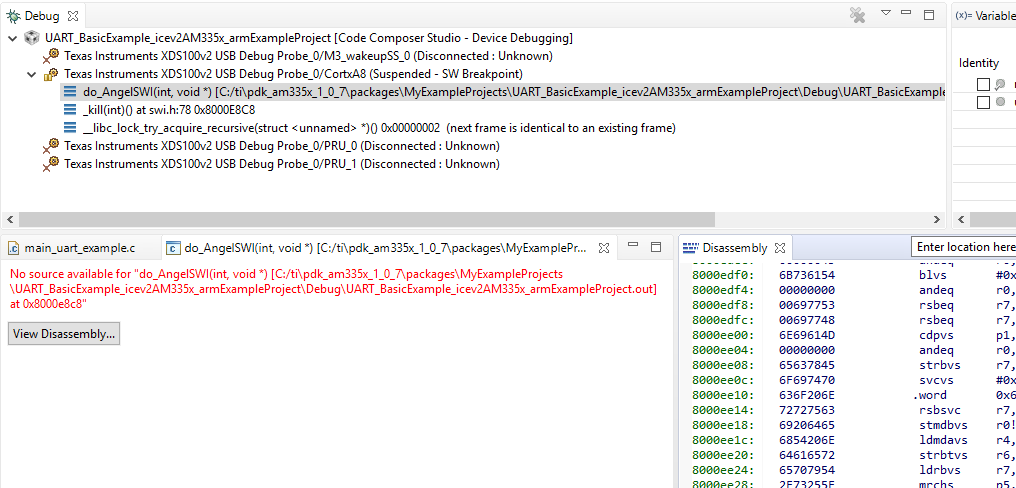

  • Hi Vinay, I was able to reproduce the issue. In my test, I didn't use Pinmux tool. I only changed BOARD_UART_INSTANCE and rebuild PDK (gmake clean, gmake all).
    If I use BOARD_UART_INSTANCE = 4, I got the same results, as you, in CCS (do_AngelSWI). In order to get more information, I enabled print errors in the project CCS .cfg file (am335x_app_icev2am335x.cfg). Below summary of changes in .cfg file:

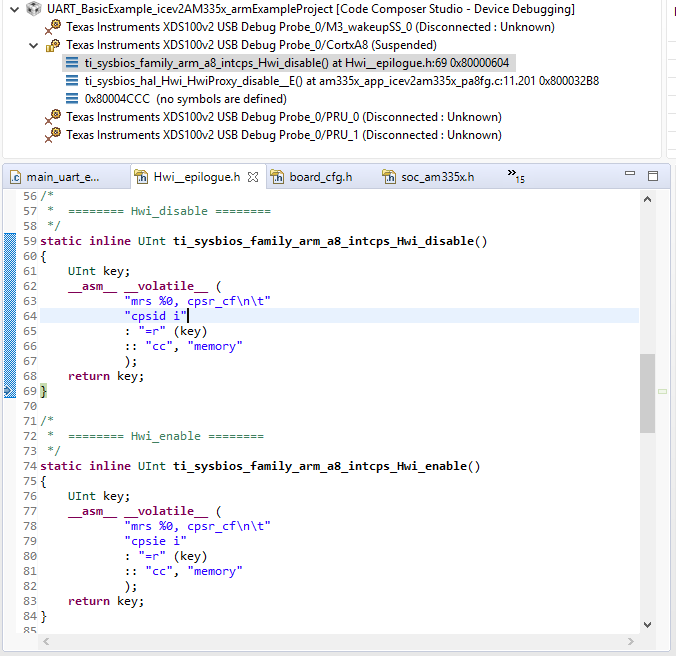

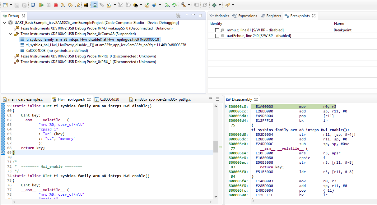

  • Paula, When I perform exactly like your experiment the thread will be running but no output in the terminal. I suspended/paused the debug to check which function is executing its always running ti_sysbios_family_arm_a8_intcps_Hwi_disable() repeatedly.
    Find the screen shot bellow.
    Is this same at your end too?
    vinay

    4) Confirm in CCS project properties, that UART_BasicExample_icev2AM335x_armExampleProject is using PDK 1.0.10, and rebuild the project.

  • Hi Paula, I installed latest PSDK 4.3 and followed the instruction you mentioned above. The response/output is still same.
    When I connect the FTDI module to Pin 7 and 8 of J3 9X2 header following is the debug output when I pause/suspend the run.
    It continuously execute ti_sysbios_family_arm_a8_intcps_Hwi_disable() and ti_sysbios_family_arm_a8_intcps_Hwi_enable() APIs.
    Please confirm did you/other employee connect FTDI and tested the UART4 or UART1?
    Thank you for your continuous support. Hope your further guidance solves my issue.
    Vinay
  • Hi Paula,
    As I mentioned I just installed PSDK 4.3 and changed instance number to 4 and rebuild only board_lib and recreated UART_BasicExample_icev2AM335x_armExampleProject in C:\ti\pdk_am335x_1_0_10\packages. compiled and executed. As I mentioned in the above post Hwi_enable and Hwi_disable() function executing repeatedly.
    In one of my post I mention that by default UART4 TX and RX pins are assigned to J18 and K15. So following are the changes I made to use pins 7 and 8 of J3 female header

  • Hi Vinay, I was able to get UART4 working on J3 pin 7 and pin 8, after modifying C:\TI\pdk_am335x_1_0_10\packages\ti\starterware\board\am335x\am335x_icev2_pinmux_data.c
    Main changes are:
    1) In #if defined(BUILDCFG_MOD_UART) change UART4 from using J18 and K15, to use E17 and E18
    static pinmuxPerCfg_t gUart4PinCfg[] =
           /* UART 4 -> uart4_rxd -> E18 */
           PIN_UART0_CTSN, 0, \
               PIN_MODE(1) | \
               ((PIN_PULL_UD_EN | PIN_RX_ACTIVE) & (~PIN_PULL_TYPE_SEL)) \
           /* UART 4 -> uart4_txd -> E17 */
           PIN_UART0_RTSN, 0, \
               PIN_MODE(1) | \
               ((PIN_PULL_UD_EN) & (~PIN_PULL_TYPE_SEL & ~PIN_RX_ACTIVE)) \
        {PINMUX_INVALID_PIN}
    2) Delete gpio1[9] (which uses E17) inside gGpio1PinCfg[]
    3) Delete Sync0 and Sync1 inside gPru_icss1PinCfg[],as they use E17 and E18
    4) Clean and Rebuild PDK libraries
    5) Clean and Rebuild your CCS program
    6) Confirm FTDI connection and test

  • Thank you so much Paula. It worked.
    Interrupt number in pdk_am335x_1_0_7 was wrongly mapped and corrected in pdk_am335x_1_0_10.
    I took care for setting E17 and E18 for UART for and removed GPIO1_9 pin in configuration earlier but was missing out with  Sync0 and Sync1 inside gPru_icss1PinCfg[].
    Now I will try the same with UART1 and keep you updated.
    Best regards
    Vinay Venu
  • My one important question is if i want to add an Interrupt for uart transmission or reception to this example project what are the steps to follow. I don't see any ISR in the project path. I believe its included in the library so please give me more details on this. Thank you!
  • Hi Paula,
    Try with respect to <uart1 was not successful.
    Similar to the previous suggestion, I deleted pr1_uart0_rxd and pr1_uart0_txd as it was using D16 and D 15 respectively.
    Rebuild completely, that is >gmake clean and gmake all.
    To be double sure i completely deleted gPru_icss1PinCfg[] and variables using it to make sure that UART1 is not used by any other device/peripheral. If you look at the schematics there are  4 jumpers for CAN /PROFIBUS SELECTION.
    As UART1 is accessible from profibus i used J8 to select profibus(shorting profibus_a and can_gnd/profibus_a)
