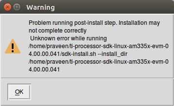

    Also, When I installed Ti's SDK in ubuntu 16.04, it pop up the warning message in the attached pic.
    Can you please guide me "How to solve these errors ?" and install the CH341 driver in BBB successfully?

  • Seems the sed command doesn't work on your system. Could you download that https://e2e.ti.com/cfs-file/__key/communityserver-discussions-components-files/791/sdk_2D00_install.sh script, place it to ti-processor-sdk-linux-am335x-evm-04.00.00.04 directory, run it and post the feedback.
    $ cd ti-processor-sdk-linux-am335x-evm-04.00.00.04
    $ chmod +x sdk-install.sh
    $ ./sdk-install.sh
  • Hi Kemal,
    I followed the same procedure that you mentioned. But, I received the following error, when I executed the sdk_install.sh.
