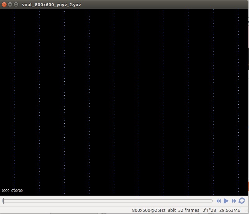

Linux/AM5728: VIP firmware error
Part Number: AM5728
Other Parts Discussed in Thread: TVP5150, TVP5150AM1,
Tool/software: Linux
We are using ti-processor-sdk-linux-am57xx-evm-04.02.00.09 release to develop our custom board. We faced the problem of TVP5150 is detected but vip couldn't get firmware. In our design, the tvp5150 is controlled via i2c2 and the 8 bits output of tvp5150 is connected to VIN1A_D23 ~ VIN1A_D16. But we got vip error message below:
[ 3.028856] tvp5150 1-005d: tvp5150 (4.0) chip found @ 0xba (OMAP I2C adapter)
[ 3.036108] tvp5150 1-005d: tvp5150am1 detected.
[ 3.062473] vip 48970000.vip: loading firmware vpdma-1b8.bin
[ 3.062538] vip 48970000.vip: Direct firmware load for vpdma-1b8.bin failed with error -2
[ 3.062546] vip 48970000.vip: couldn't get firmware
[ 3.082461] vip 48990000.vip: loading firmware vpdma-1b8.bin
[ 3.082519] vip 48990000.vip: Direct firmware load for vpdma-1b8.bin failed with error -2
[ 3.082524] vip 48990000.vip: couldn't get firmware

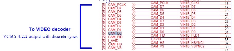

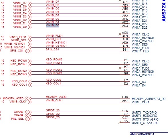

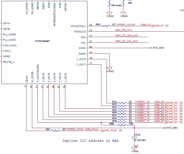

Our HW circuit diagram is below:
AM5728 side:
Connector:
TVP5150 side:

    I was confused about the vin1a/vin1b.  My circuit diagram set as below:
    BALL NAME                 MUXMODE                 SIGNAL NAME
    vin1a_d23                            1                            vin1b_d0
    vin1a_d22                            1                            vin1b_d1
    vin1a_d21                            1                            vin1b_d2
    vin1a_d20                            1                            vin1b_d3
    vin1a_d19                            1                            vin1b_d4
    vin1a_d18                            1                            vin1b_d5
    vin1a_d17                            1                            vin1b_d6
    vin1a_d16                            1                            vin1b_d7
    In the dts file, should set  vin1a/vin1b ?

    By using command「yavta -c60 -fYUYV -Fvout_800x600_yuyv.yuv -s800x600 /dev/video1」of VIP User Guide
    We can save yuyv format video, since the camera is not attached the screen is black.

  • Your question is not clear from above post. Are you saying that camera is not getting detected and the captured images are black meaning that camera is not streaming anything?
    Are you streaming embedded sync or discrete sync data from TVP5150? If it is embedded sync, then remove the hsync-active and vsync-active configuration and insert channels = <0 > configuration.

    No, Since I don't have NTSC format camera on hand till now, so I left the AIP1A input port of TVP5150 open. I think the captured black screen is reasonable.
    I will stream discrete sync data from TVP5150. My final goal is TVP5150 decode NTSC camera signal then encode H.264 format and send to Host PC via Ethernet.  Do you have any recommend threads or documents ?
    Collin
  • Okay, so it seems like you are able to resolve the camera capture issue. Now you need example on how to encode the captured image and stream it. You can use gstreamer pipeline for same, example below -
