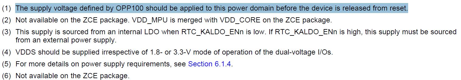

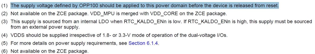

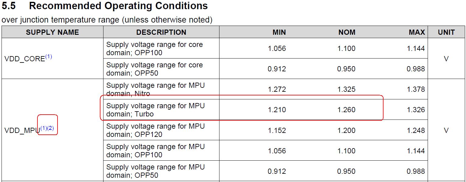

We know that in the discrete power solution design, the power supply of VDD_MPU is fix. If AM3356 VDD_MPU works in TURBO mode,  it requires VDD_MPU input is 1.26V.But in AM335x datasheet table 5, we see below words:
The supply voltage defined by OPP100 should be applied to this power domain before the device is released from reset.
So we want to know if use discrete power solution and VDD_MPU works in TURBO mode, does VDD_MPU sill need to be OPP100 mode (1.1 V input) before the device is released from reset or VDD_MPU could input as 1.26v (Turbo mode) before the device is relased from reset?
PMIC should be no problem, but customer want to use discrete power solution, so we have this question and need your double confirmation,
