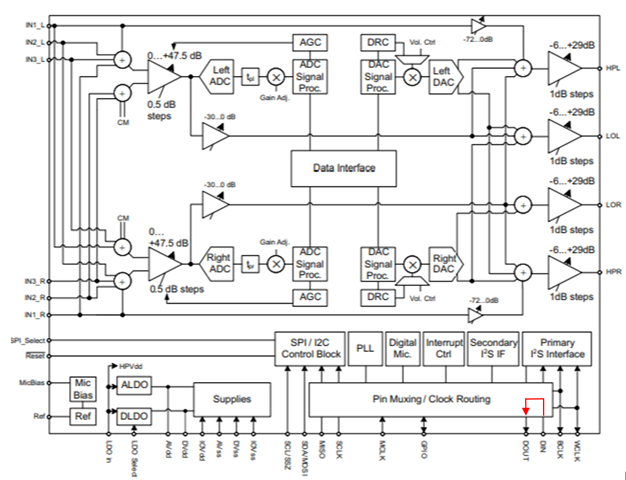

Part Number: TLV320AIC3204
When the loopback is enabled, how the input data is routed?
Could you show it on the block diagram?

Hi Kuramochi-san,
This loopback just routed DIN to DOUT. I have pasted an image for reference below:
