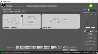

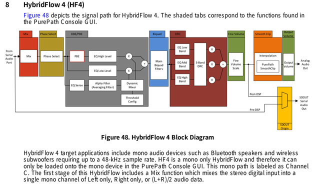

    In other words, we check the user's guide of HybridFlow Processor, there is a HF4 on cross reference, I think Mono PBTL mode belongs to this reference, right?
    In HF4 reference, the mono path is labeled as Channel C. The first stage of this HybridFlow includes a Mix function which mixes the stereo digital input into a single mono channel of Left only, Right only, or (L+R)/2 audio data. perhaps P0-R40 is not used for this mix function, can you tell me which register to control mix function?
    Because we have two TAS5754M in Mono PBTL mode, both of them share a digital data line, we want to set one to mix Left only, and the other one set to mix Right only. Is this possible?
    many thanks
    Denny
  • Hi Denny,
    Yes, it's possible. The PPC2 GUI for TAS5754 has the options as you mentioned. The mixer registers are in Page 33, reg 0x1C~0x1F for left channel, 0x20~0x23 for right channel.
    General developing approach is customer using the GUI to do tuning, and dump out the configurations into a .h file to be integrated on customer's systems.
    Are you able to use this approach?
    Thanks!
    Sam
  • Add a screenshot for your reference.
