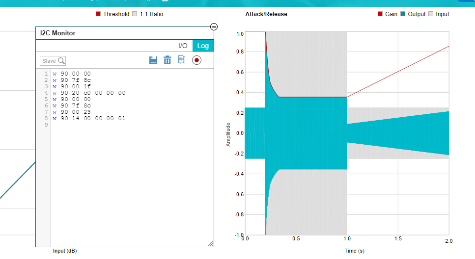

Hi Sirs,
My customer found a system integration problem with AGL function. The AGL function works with system tuning page, while the the AGL does not take effect with CFG which was generated in system integration page. Would you pls compare the enclosed PPC3 profile and CFG and point out the problem?

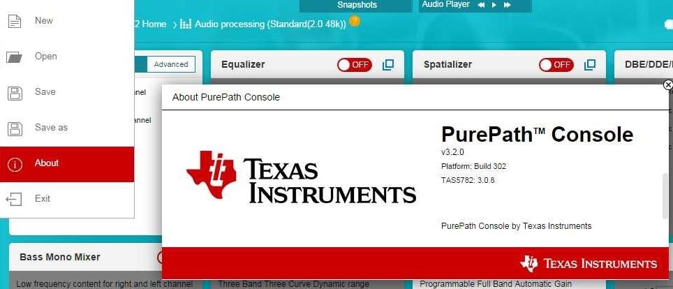

  • Hi Wayne,
    I've checked the .cfg file. The AGL configuration (line 1473-1512) is corresponding to the ppc3 profile.
    Does it work when using PPC3?
    Thanks!
    Sam
  • Hello Sam,
    Thank you for your reply. The AGL works with PPC3 GUI, but does not work with CFG.
    Thanks a lot.
    Wayne Chen

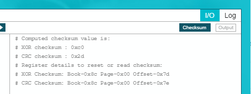

  • Hi Wayne,
    Has customer confirmed the I2C writing works well? For example, they may change some option like the switching frequency in the script file, and see if it is effective. Or just read the checksum registers.
    Thanks!
    Sam
  • Hello Sam,
    We will cowork with customer to verify checksum register and get you back shortly.

  • Hello Sam,
    Please refer to the enclosed I2C log captured on customer's system board.
    We got correct I2C sequence, the CRC and XOR checksum readings are in line with PPC3 GUI's computed data:

    dvTI5782M_Checksum_Read read XOR checksum start
    addr = 0x94, reg = 0x00, data=0x00, len = 1, CmdLine=1
    addr = 0x94, reg = 0x7F, data=0x8c, len = 1, CmdLine=2
    addr = 0x94, reg = 0x7D, data=0x01, len = 1, CmdLine=3
    TAS5782 Master : read XOR readCount=1, checksum=0xc0
    dvTI5782M_Checksum_Read read CRC checksum start
    addr = 0x94, reg = 0x7E, data=0x01, len = 1, CmdLine=3
    TAS5782 Master : read CRC readCount=1, checksum=0x2d

    line1651: TAS5782 Master : read XOR readCount=1, checksum=0xc0
    line1657: TAS5782 Master : read CRC readCount=1, checksum=0x2d
    The PPC3 version of TAS5782 is V3.0.8

    I tried to open customer's PPC3 GUI, toggling AGL parameters and watch the I2C monitor.
    Got the following I2C Script:
    w 90 00 00
    w 90 7f 8c
    w 90 00 1f
    w 90 20 c0 00 00 00
    w 90 00 00
    w 90 7f 8c
    w 90 00 23
    w 90 14 00 00 00 01
    w 90 00 00
    w 90 7f 8c
    w 90 00 1f
    w 90 14 02 dd 95 8a
    w 90 00 00
    w 90 7f 8c
    w 90 00 23
    w 90 14 00 00 00 01
    w 90 00 00
    w 90 7f 8c
    w 90 00 1f
    w 90 18 0a 0a ae d2
    w 90 00 00
    w 90 7f 8c
    w 90 00 1f
    w 90 28 75 f5 51 2e
    w 90 00 00
    w 90 7f 8c
    w 90 00 23
    w 90 14 00 00 00 01
    w 90 00 00
    w 90 7f 8c
    w 90 00 1f
    w 90 1c 00 03 69 d0
    w 90 00 00
    w 90 7f 8c
    w 90 00 1f
    w 90 2c 00 00 57 62
    w 90 00 00
    w 90 7f 8c
    w 90 00 23
    w 90 14 00 00 00 01
    w 90 00 00
    w 90 7f 8c
    w 90 00 1f
    w 90 1c 00 03 69 d0
    w 90 00 00
    w 90 7f 8c
    w 90 00 1f
    w 90 2c 00 00 57 62
    w 90 00 00
    w 90 7f 8c
    w 90 00 23
    w 90 14 00 00 00 01
    I compared the script with PPC3 CFG. Found PPC3 CFG contains those data already, wile we see extra data at book 8c, page 1f, register 25~27, book 8c, page 1f, register 17.

    0x90 - B0x8c (140) / P0x1f (31) / R0x23 (35) = 0x00 = 0000 0000 # 1488
    0x90 - B0x8c (140) / P0x1f (31) / R0x24 (36) = 0x00 = 0000 0000 # 43
    0x90 - B0x8c (140) / P0x1f (31) / R0x25 (37) = 0x20 = 0010 0000 # 44
    0x90 - B0x8c (140) / P0x1f (31) / R0x26 (38) = 0xc4 = 1100 0100 # 45
    0x90 - B0x8c (140) / P0x1f (31) / R0x27 (39) = 0x9c = 1001 1100 # 46
    0x90 - B0x8c (140) / P0x1f (31) / R0x28 (40) = 0x75 = 0111 0101 # 1492
    0x90 - B0x8c (140) / P0x1f (31) / R0x29 (41) = 0xf5 = 1111 0101 # 1493
    0x90 - B0x8c (140) / P0x1f (31) / R0x2A (42) = 0x51 = 0101 0001 # 1494
    0x90 - B0x8c (140) / P0x1f (31) / R0x2B (43) = 0x2e = 0010 1110 # 1495
    0x90 - B0x8c (140) / P0x1f (31) / R0x2C (44) = 0x00 = 0000 0000 # 1499
    0x90 - B0x8c (140) / P0x1f (31) / R0x2D (45) = 0x00 = 0000 0000 # 1500
    0x90 - B0x8c (140) / P0x1f (31) / R0x2E (46) = 0x57 = 0101 0111 # 1501
    0x90 - B0x8c (140) / P0x1f (31) / R0x2F (47) = 0x62 = 0110 0010 # 1502
    0x90 - B0x8c (140) / P0x1f (31) / R0x30 (48) = 0x7f = 0111 1111 # 47
    0x90 - B0x8c (140) / P0x1f (31) / R0x31 (49) = 0xff = 1111 1111 # 48
    0x90 - B0x8c (140) / P0x1f (31) / R0x32 (50) = 0xff = 1111 1111 # 49
    0x90 - B0x8c (140) / P0x1f (31) / R0x33 (51) = 0xff = 1111 1111 # 50
    0x90 - B0x8c (140) / P0x23 (35) / R0x14 (20) = 0x00 = 0000 0000 # 1506
    0x90 - B0x8c (140) / P0x23 (35) / R0x15 (21) = 0x00 = 0000 0000 # 1507
    0x90 - B0x8c (140) / P0x23 (35) / R0x16 (22) = 0x00 = 0000 0000 # 1508
    0x90 - B0x8c (140) / P0x23 (35) / R0x17 (23) = 0x01 = 0000 0001 # 1509

    Customer can reproduce the problem. We also confirmed that the TAS5782 CFG contains AGL code, but we may need to adjust the programming sequence to activate the feature:
    1. Program Sequence #1:
    (1) Write TAS5782 CFG (w/AGL code)
    (2) Play Music -> AGL does not take effect
    2. Program Sequence #1:
    (2) Play Music
    (3) Write AGL Code -> AGL works
    PPC3 profile and CFG were attached.
