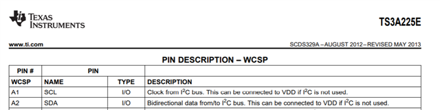

Dear expert,
I non-I2C system application, can SCL/SDA pin be tied directly to VDD without any pull-up resistors? We met some layout challenge at WCSP package.
Dylan
Dear expert,
Dylan
Hi Dylan,
Yes, you can tie the unused I2C pins directly to VDD without a pull up resistor if they are not being used.
Thanks!
Bryan
