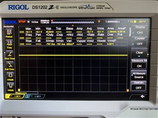

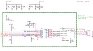

Due to supply issue we are switching our woofer amp TAS5825M to TAS5805M and we are mocking few units with TAS5805M part. During bring up we are seeing below issue
1. Woofer works for few seconds (<10sec) at low volume level <30% and then it stops working no woofer output (I2C works fine but Fault pin triggered). We did checked the fault registers every time the issue happened one or two fault registers are set
0x70 -> 02 or 03 (Over current)
0x71 -> 04 (clock fault) - There should not be any clock fault because we have this TAS5805M driver is working with similar other product  using TAS5805M
0x72 -> 01 (over temperature ) - Over temp fault is happening most of the time but I did checked the chip temp but I don't see it is very hot.
2. If the volume level is set more than 60%, the woofer output stops from the start and it doesn't play for few seconds. During this case we are seeing same OT and clock fault but I dont think chip will reach max temperature as soon as it starts playing.
Can you help debug this issue?
